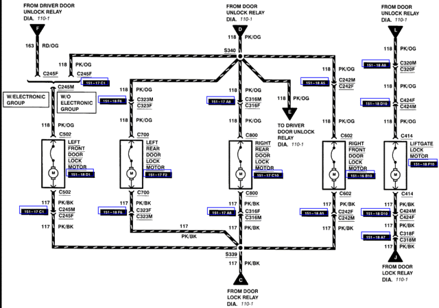

Hmm, it seems strange that just the passenger door would unlock, because the passenger door and both rear doors all receive power from the same splice in the circuit:
When you have this problem, do all of the doors not work together? Or is it one or the other?
