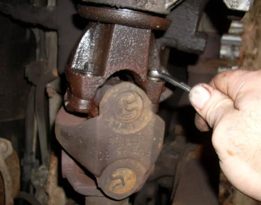

heres what it looks like. not a picture of mine BTW
heres a thread about a adapter for the cv flange but im not sure if the awd unit is the same as a part time unit flange.
