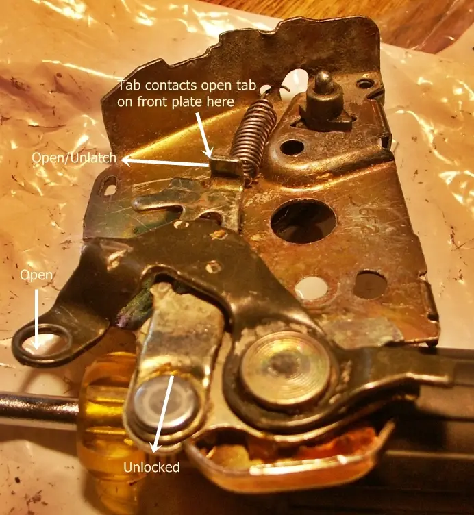

Lock Internals Pictures Added
I was bored today and its raining sideways, so I drilled the lock apart and took pictures. Maybe it will help someone else and prevent them the grief I went through to figure out how the guts of a thing work that I had never seen the inside of. Its full of magic and the magic is held in by 5 cent springs. If a spring breaks it lets the magic out.
The spring that you can see through the large hole was broken and fell out on disassembly. No idea where it went or what it does.
The outside handle linkage was what I used to open the door by means of a large screwdriver through the hole in the door, at about a 45 angle on the edge of the linkage. Gave it a hard rap with my hand and it popped open.
The circled hole shows inside the where the latch tab is that must be pushed to open. You might get lucky and open it here with a screwdriver

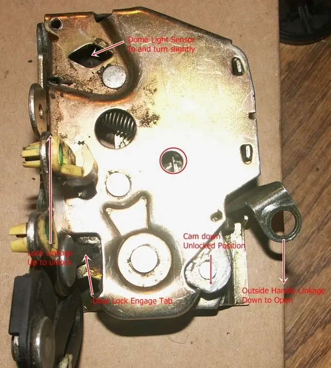

Dome light switch goes in the diamond shaped hole in the top picture and turns about 30d to lock in and line up with the screw. It comes with a new latch assembly. It rides on a cam shown in a later picture to turn on the light. Pushed in is closed to turn on the light.

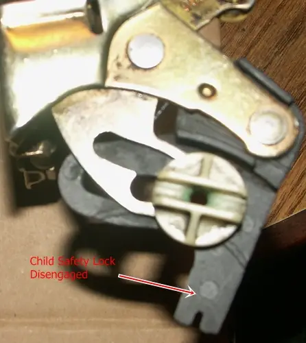

When the child safety lock is disengaged, it allows the inside inside handle linkage to engage the unlatch cam by catching the lower part of the slot.
Child safety lock engaged, linkage misses the unlatch cam from inside door handle. Child safety latch affects inside handle only. Inside handle linkage goes through the white button. Pay attention to its orientation so that it will clear locking linkage on reassembly.
This is the inside of the latch back plate, the part you can kinda see through the holes in the door. You can see the ears on the dome light sensor and where the infamous little spring connects to the plate. When unlocked the opening tab is in a lower position and should contact the unlatch tab on the front plate, shown with an open label below.
Inside of the back plate shown in locked position. In locked position the tab slides up to clear the opening tab on the front plate, it won't contact it.

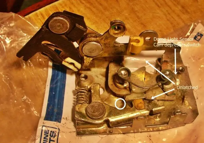

The front plate, the part that the screws go in to. Shown in latched position.
The white circle is approximately where the hole is in the back plate. Its this arm which must disengage the latch. Note the door latch "claws" are closed.
Front plate again, shown unlatched. Dome light sensor rides up on high point of cam to depress and turn on light. Unplugged, the light goes out
