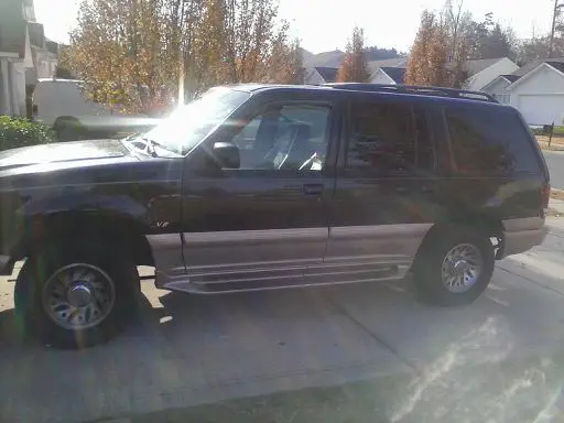

Alrighty, I have recently picked up a '00 5.0 Mounty AWD donor with 167k on her to swap under my '01 3.0 Ranger ext-cab with torsion bars. I got it for the powertrain hoping I could salvage any nifty interior pieces if they were in decent condition.. not so much. most of the interior is literally falling apart to the touch (mirror, arm rest, seat, back window..). Who cares, I wanted the powertrain anyway so I am good.
After seeing the condition of the interior, I couldn't imagine the previous owner cared too much about what was under the truck either. So I jumped under there with my phone-cam and this is what I've got to work with. I'm hoping someone might feel generous enough to let me know how serious any of these problem areas may be and what I may need to do to fix them..
What type of stuff do you guys see me running into here?

I've played around with 2.3's, rebuilt my 3.0 with a Taurus block, done motor swaps in other cars, blah blah. I don't know jack about these V8's or the awd powertrain other than what I have read. I hear the transfer cases for the awd's like to eat themselves and their associated differentials on pavement when not a matching tire on the thing can be found. Looking at these dark spots tells me not everything is as it should be so I am hoping I won't have to burn my wallet getting things back in good shape.
