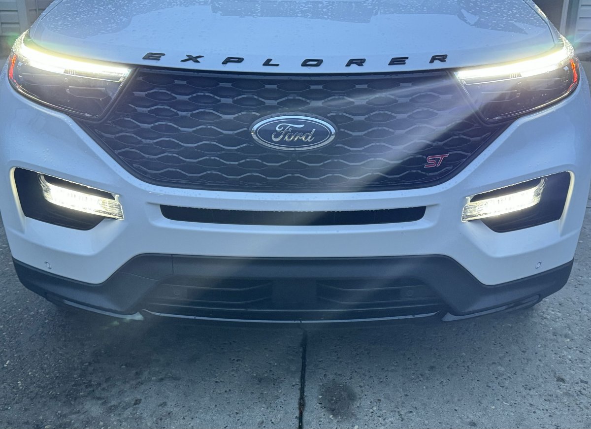

Hey all! I just wanted to write this FORScan changes to those who are interested!
The following FORScan changes below allows you to use your white LED bars brightened up in your headlights at night time without using your low beams—also will work during the day as well with the Explorer being in park. By default, Ford has made this option dim during day and night time, this fixes that!
This would be perfect for those going to car meets like myself, wanting to take pictures at day/night, etc and want to have your led bar on, this is for you!
To note, I’ve first found this out by my own for my 14th gen F-150s and posted in the 14th gen F-150 forum (same screen name), which I’m very well known for among several FORScan changes. @powerboatr can personally vouch for me.
**Below is the picture of my ST in night time taken at a friend's house just now, in headlight switch/knob number 2 and in drive, not parked. Low beams do not turn on, just the white LED bar with fog lights. You can use the fog lights on or off with it, which works perfectly in switch 2! If you wish to use your low beams, just simply go back to auto mode (switch 3), it's that easy!
**This will work for all 2020+ Explorer trims with LED bar in their headlights, will not work with FPIU due to amber DRL.
AS ALWAYS, BACKUP YOUR BCM MODULE BEFORE MAKING THE CHANGES!
Values to change in BCM (as-built): BCM -> 726-42-01 -> x2x2-xxxx-xxxx
*REMEMBER--leave the "x"s alone, only change the numbers (2)

Yes sir, as long as you stay in mode 3 on your headlight switch (auto mode), operates like normal at night!
--Same change I found 2+ years ago for the 14th Gen F-150 forum and it went viral quick--this FORScan change works the same way for this mod for our Explorers! Which a huge plus!
Drivers can use the mode 2 on headlight switch without using auto mode and low beams won't come on if they wish to only use the LED white bar at night in the city if they wish to. Options are there when you need it! ;)
