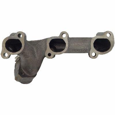

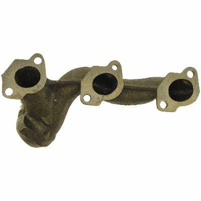

I replaced my engine last spring and noticed the exhaust manifolds were blocking part of the exhaust port...The manifolds looks like the right picture...
The manifolds I am replacing the original ones are from a 97 Explorer... The ports are more than 19% larger than the ones from my 99 Explorer...You can see the difference between the two...1.7" vs 1.4" inches in diameter...

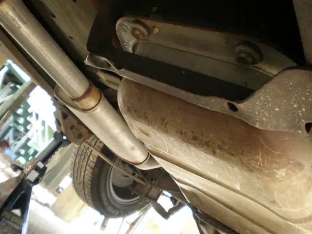

Now about dual exhaust...The 3rd picture is the current 2.5" pipe coming off the second rear cat into a single muffler and a single pipe out the back...
The muffler I have a stainless steel Mangaflow dual-in/dual-out 2.25" ports that is the same physical size as the single 2.5" muffler on there now...The piping will not be any further outside the envelope of the muffler and two pipes should fit without issue on the passenger side in the space that one pipe is resting in now...
After replacing the manifolds, I am going to replace the cats in the primary pipes and the 2 downstream cats as well as using a Magnaflow dual-in/dual out muffler and running the exhaust pipes out the back like the single pipe runs out...I plan to run 2.25" pipes throughout the system to maintain exhaust velocity and run the 2 cats in parallel[ one in each pipe instead of both in series] and add the back O2 sensor to one of the rear cats...I will run the pipes down the passenger side and not need to move any components under the truck...
