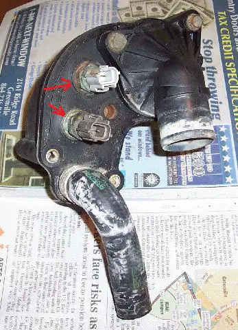

I have a 1999 Explorer with the 4.0 SOHC engine . On the thermostat housing there are two sensors. I removed the housing and now I can't remember which connector goes to the sensor on the left when facing the engine and which one goes to the right sensor. One connectors is orange in color and the other connector is gray. Please let ne know or send a picture.

Are you talking about the MAF?
They should only fit one way.
ECT sensor
The sensors will fit in either hole but are different colors and the electrical connectors are keyed differently.
Thanks Street Rod, that is exactly what I was looking for!
