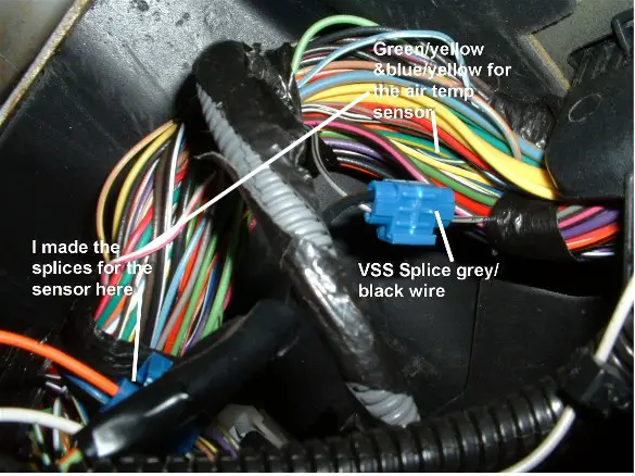

I've been meaning to put this pic on for awhile so here it is. All explorers have the wiring harness' for the temp sensor allready there on the bumper support bracket. All you have to do is run the wires from the console down to the right area which is on the driver side just above the parking brake pedal and slice into the factory wire harness. Heres how I did mine.

So those stupid wires WERE under there! I finally gave up searching for the correct wires and ran my own. Wish you had posted this 6 months ago!!! Nice job, I'm sure the info will help many on here.
