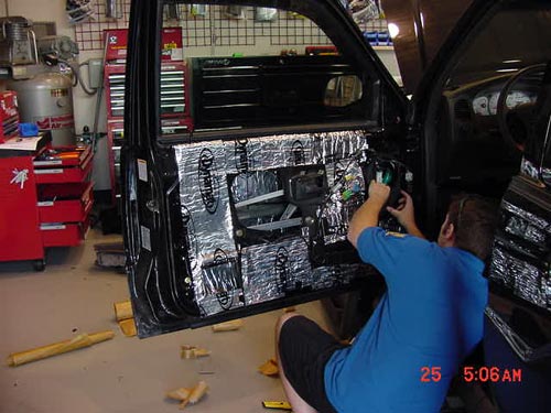

In my '94 I placed dynamat between the door and the bracket for the speaker, and then again between the bracket for the speaker and the speaker itself. Honestly, there was not a noticable difference with just that. It was when I covered both the door and the door panel and the rest of the surfaces of the truck with 1 or more layers of dynamat that I noticed a difference, and a big difference at that... Mine is now like a tomb at highway speeds (65 miles/hour). And when I had my system, nothing rattled.
We completely covered the door skin and the inner door. That way you keep out the road noise. Plus it makes the door sound solid when you close it.
Your pics do not show up for me???????
I would really like to see your install.
