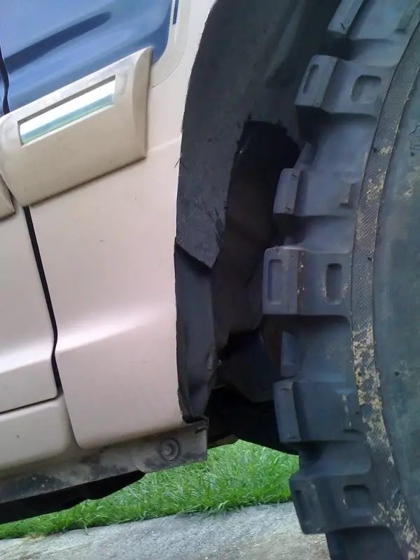

I completed the trimming on the front. I now have full clearance for the 34x10.50x15 LTBs on only 2" lift.

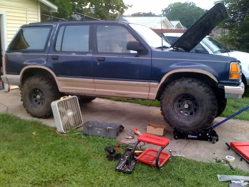

Testing clearance during the trimming:
Most of the scrap that was removed:
Inside the passenger fender (you can see where I trimmed the inner fender):

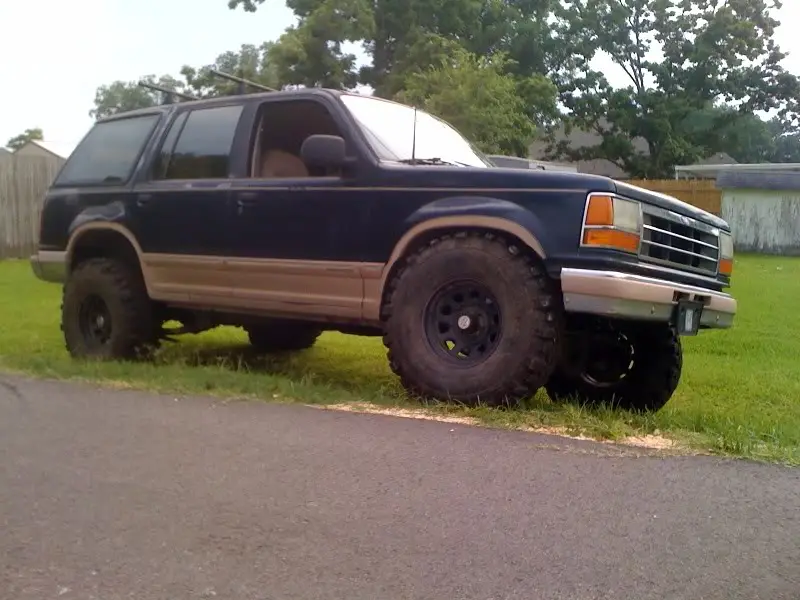

A couple poser shots to get a more realistic idea of whether I'll clear:
The tires cleared fine on the one trail ride I caught, about a month ago... but the A4LD blew out and I've been working on swapping in a M5OD since, getting hung up by some stupid **** on basically every damn step of the process.
