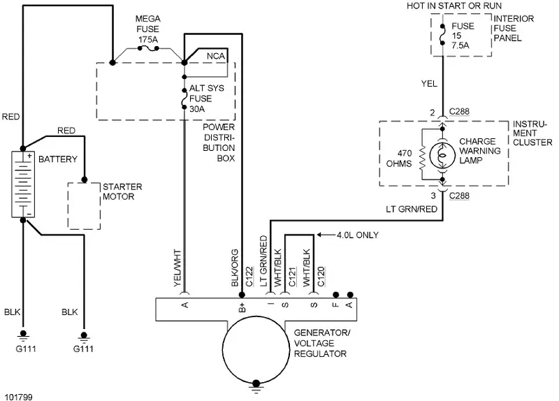

You didn't post if you have the V6 or the V8. The charging circuit (V6 shown) is fairly simple.
Check the 30 amp fuse in the power distribution box. I don't know the fuse number - find it in your Owner's manual.
Yea, checked with Digital volt meter and to make sure reading correctly compared on van also and it read correctly. I did disconnect regulator connector from alt. yellow stripe and green from there and alt. put out was 12.5 volts, am I missing something.Does the PCM have anything to do with this setup?
