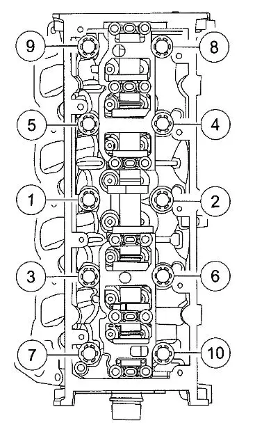

Tighten the LH cylinder head bolts in 6 stages in the sequence shown in Fig. 433.
Stage 1: Tighten to 40 Nm (30 lb-ft).
Stage 2: Tighten an additional 90 degrees (1/4 turn).
Stage 3: Back out 1 full turn (360 degrees).
Stage 4: Tighten to 40 Nm (30 lb-ft).
Stage 5: Tighten an additional 90 degrees (1/4 turn).
Stage 6: Tighten an additional 90 degrees (1/4 turn).
Tighten the RH cylinder head bolts in 6 stages in the sequence shown in Fig. 434.

Fig 433 on left (9 is top left,) Fig 434 on right (9 is top right.)
