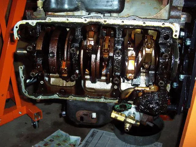

thanks to everyones quick response. we finally found the two bolts we were missing. they were the ones all the way at the top twelve o'clock position. we got it out. yay!!! now we need to go on to the next fun issue. we dropped the cover that calls itself an oil pan. and the oil looks like blackish Vaseline. Wtf? I've worked on a lot of cars and seen a lot of bad oil. but i have nevet seen anything like this! any ideas?
low coolant temperature?
Some people who experience engine overheating mistakenly remove the thermostat or install a low temperature thermostat. This results in rapid generation and accumulation of sludge.
Frequent short trips and infrequent oil changes can also result in excess sludge.
thanks 2000streetrod. we'll double check to see if the took out the thermostat. this was a vehicle that was relegated to their son driving it back and forth to school and soccer games.so i don't know how far it got driven. probably not much.
I've just never seen oil look like this this stuff is more like shoe polish or Vaseline, margarine consistency. all the sludge I've seen is the oil getting thicker like syrup and then burning up and get crusty. this is just some weird stuff. have to run some tranny fluid or sea foam through it and see if everything starts flowing.
