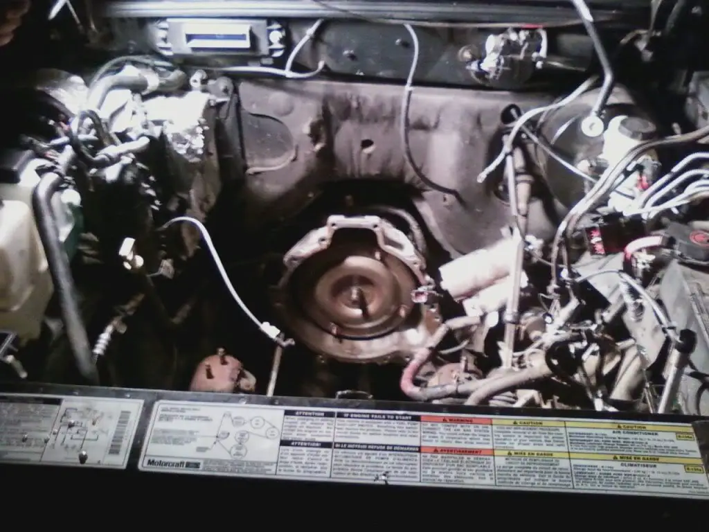

Well the engine comes out tomorrow. So far for you who are wanting to put a 2wd sohc in a 4wd car I have a little info. First the fuel rails on the 2wd have two lines that lead off the fuel rails, while the 4wd only has one( the two fuel lines converge into one) this makes for a problem when trying to reconnect the fuel lines. Simple fix is to swith fuel rails. Second The EFI( electronic fuel injection) needs to be swapped to the 2wd engine as well. That goes for injectors and basically just the whole intake manifold. I am not really sure if I need to switch the wiring harness as well(the one that sits next to the lower manifold), so if anyone knows that would be great. Another problem that I didn't forsee until now is how the heck do I get the torque converter bolts off with a locked up engine since I can't just turn the crank?

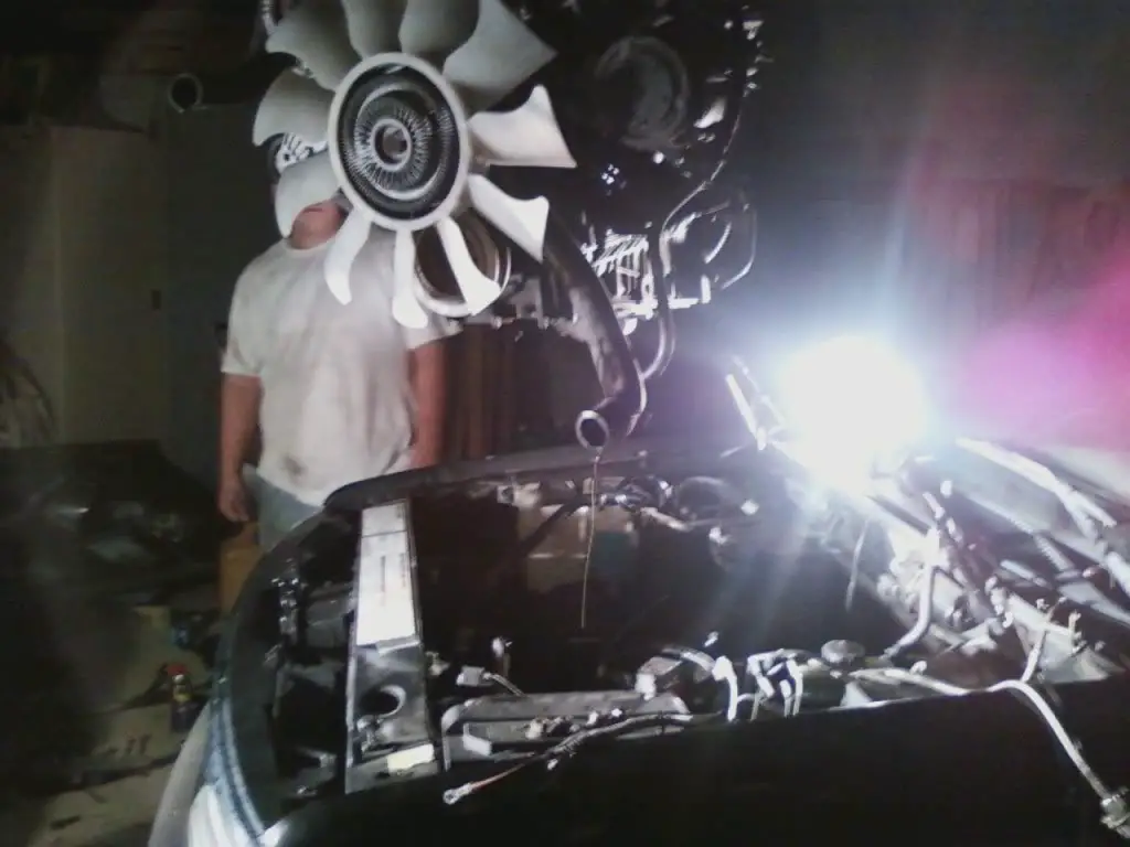

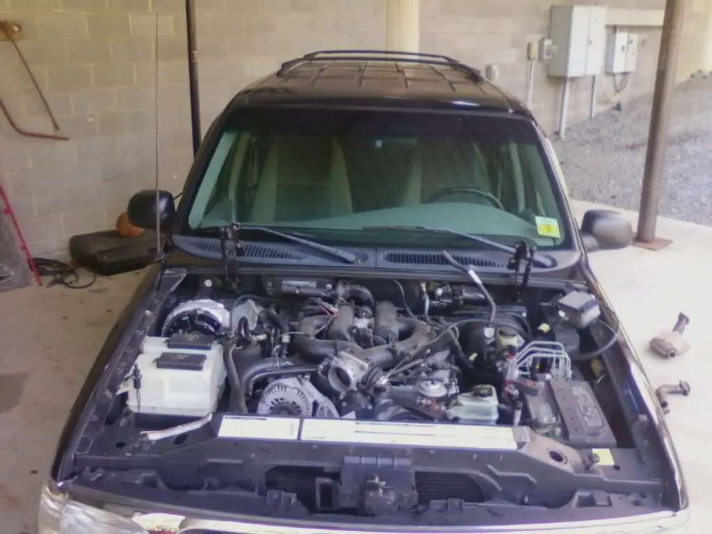

Well after 7 hours the engine is out. I've gotten the whole intake manifold off including wiring harness and injectors, rails yada yada. taking off the intake manifold makes getting to the engine to transmission bolts off very easy(the ones up top that seem to cause everyone problems) all the bolts took about 25 minutes. This weekend the engine comes out of the 2wd car and then into the 4wd exploder. I'll keep everyone posted

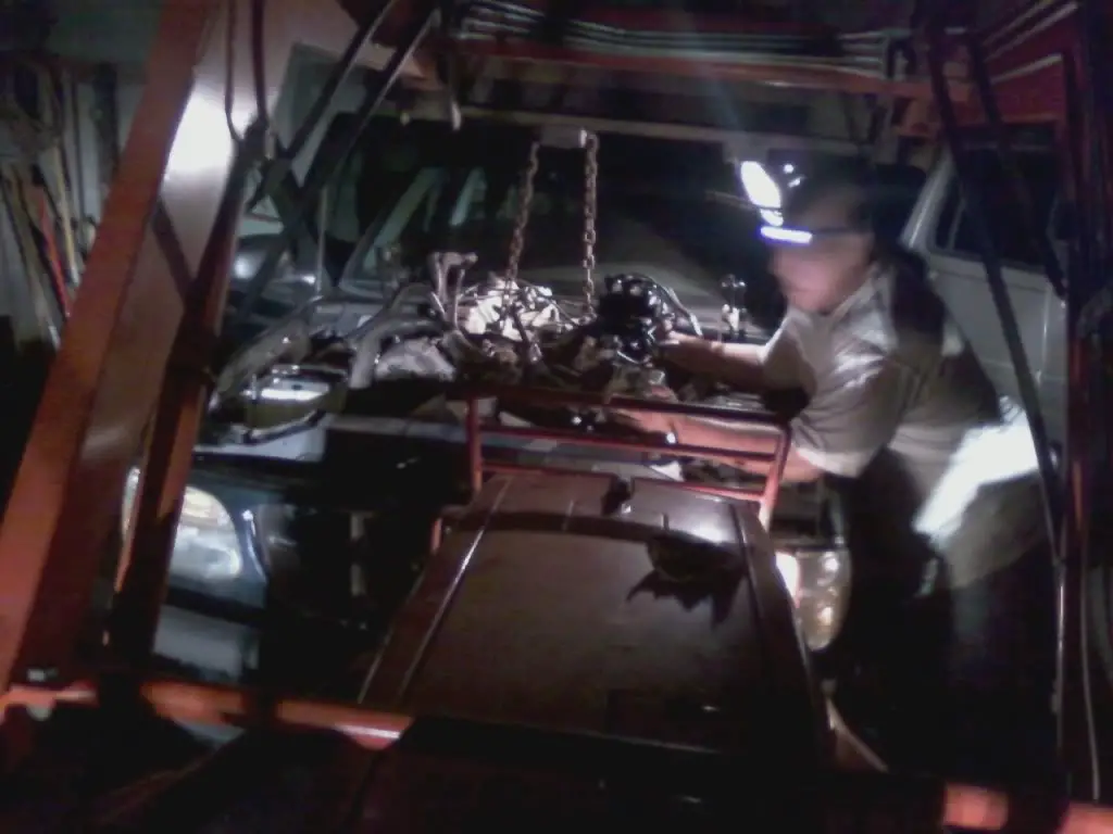

Well, its taking a little longer to get the swap done since I only have time on the weekends. I now have the good engine that came out of the 2wd out as well, Friday it goes in- hopefully after 5 hours or so I'll be cranking up the hybrid 4wd chassis explorer with the 2wd motor in it. I'll keep you all posted
The 2wd engine is in and she runs like a dream, no vibrations like the myth, just smooth runnning. Thanks for all the help guys, I'll forever owe this forum's members
