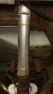

So I ended up getting a thrush turbo muffler from advance auto parts. I doesn't sound ricey (which was what I wanted) and it barks when i lay on the pedal. idle it isnt too loud but more than stock. uhhmm....thats pretty much it. ill try to get a video laterrr
its welded in. how do i take the resonator off? I like the sound but sometimes what I find weird is the fact that the engine noise is totally separate from the muffler noise lol. Meaning, I hear one noise up front and one in the back. It's an interesting concept.
The resonator is welded in. It's function is to reduce drone and is behind the muffler.

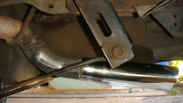

I found no increase in cab noise. Replaced it with a short straight pipe, reused the
DORKY tail spout exiting the right side, added a 2.5" Vibrant tip, and ran straight back.

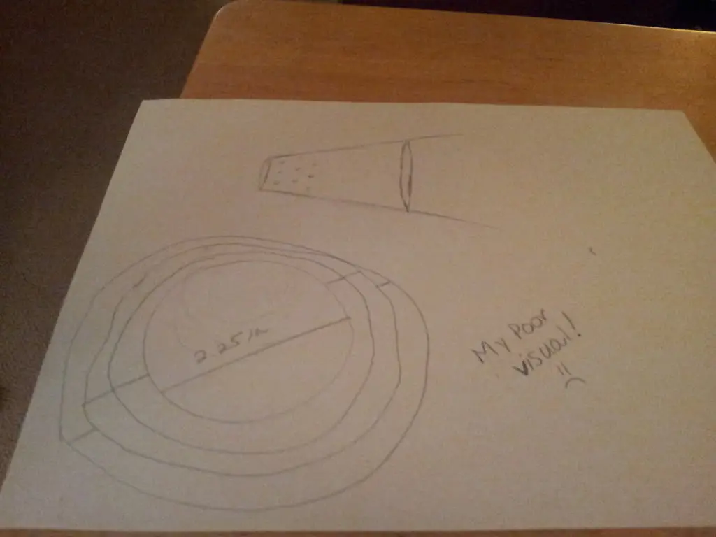

I might just make my own. I have a day off tomorrow and head to a yard to get some metal to work with. I bet I can get some metal for cheap and then just cut and bend to my liking. I am trying to think of ways to use knowledge of how sound waves can be manipulated to create different sounds, but i cant find a design that would help me...lol this is bothering me.
Okay this is probably thought of but I wanted to see if its an interesting idea. so sound can be amplified by reverberations. So...find different diameters of piping (steel, stainless, etc....). bend the tubes at one end to create cones. Then, drill holes in each differently sized pipe offsetting the holes. this would cause different vibrations thus causing a deeper sound....no??
again, sorry for the horrible drawing, but youll get the idea
