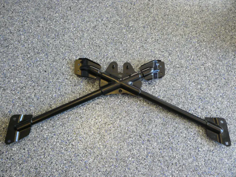

For starters, here is my freshly painted brace (they are bare and will rust, so paint or powder-coating is recommended):

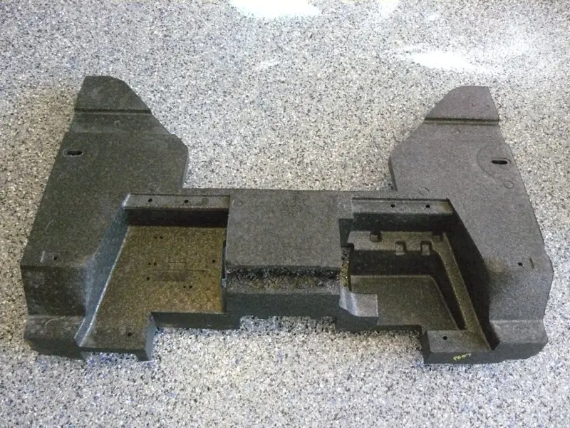

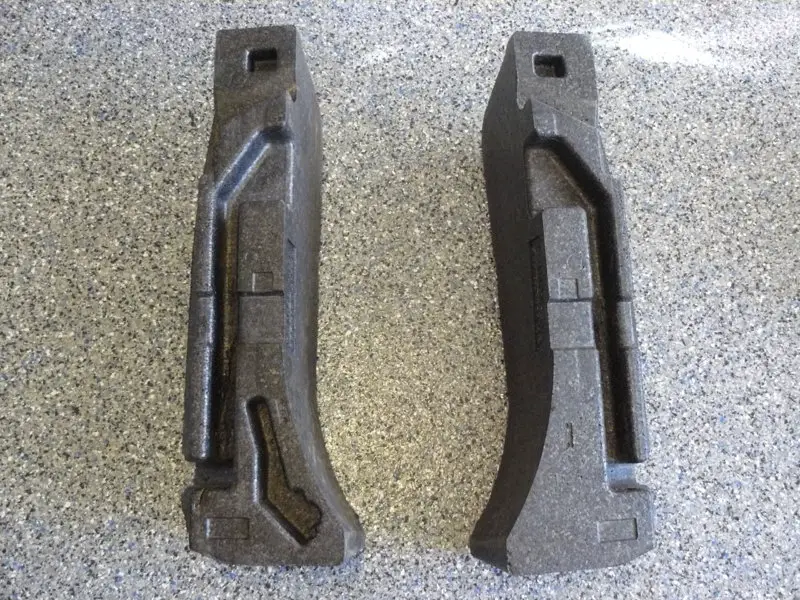

The side supports (all of which are made from styrofoam):
The front support, which tucks in behind the second row seats and allows the front floor panel to bolt on to it (it had a slight notch cut out of it from the original PD for whatever reason, but it's hidden and not noticable when the panels are over it):

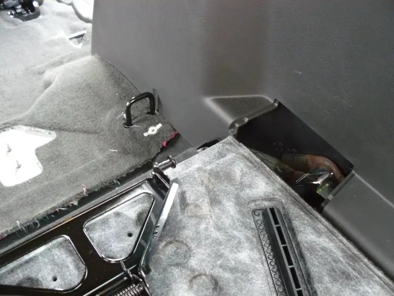

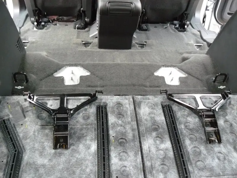

Anyway, removing the seats starts with unbolting the forward brackets/hinges that support the front floor panels when the seats are stowed. The panels are easy to lift up exposing the four 13mm nuts and the brackets themselves. Also removed are the two "U" supports that lock the seat in the upright position (shown on each side). The four bolts that hold them in (under that section of carpet) have a 10mm hex, and one of the holes is re-used for the long bolts that will hold the new forward floor panel in place.

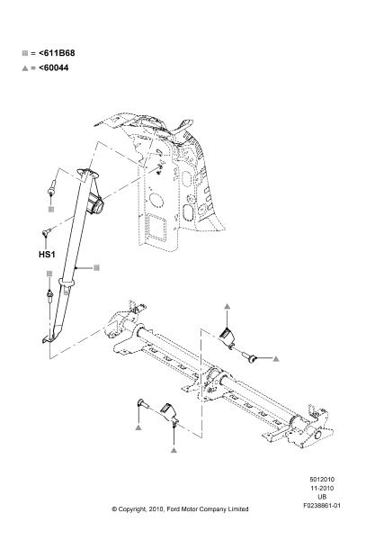

Here is the Ford diagram that shows where the seat belt assembly (right side as well) bolts in at both ends of the seat "hinge":
Once that is done, the interior panels need to be popped out and leaned inward so the four large bolts can be removed that hold the seat assembly (15mm hex). That thread listed at the top covers the removal of all the interior trim, but it's pretty simple. The rear seat weighs close to 100#, so I was glad to haul it out. Kind of a drag pulling parts off a new Explorer with just 2,000 miles, but it was for a good cause.

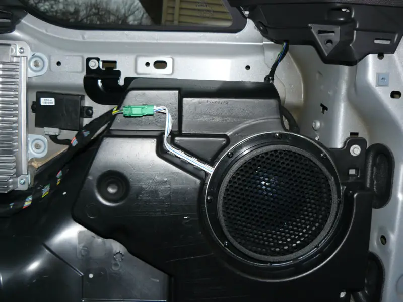

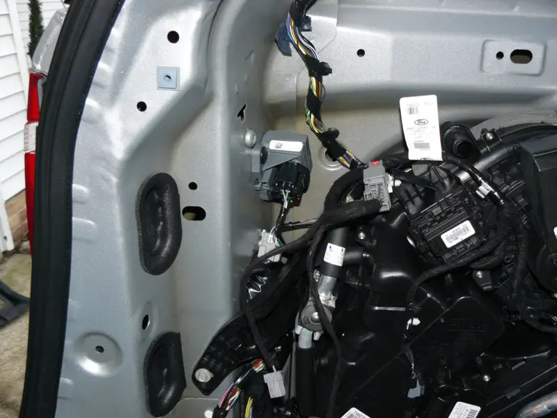

I also took out the rear seat belt mechanisms which required removal of the upper trim panels in each corner (one small bolt each plus the normal clips). There are four T-50 Torx bolts that have to come out (two each side), and for the right side, the subwoofer also needs to be taken out temporarily to access the lower Torx bolt.
Here is the left side with the mechanism removed and the lower Torx bolt threaded back in so it wont' get lost:
Similar for the right, except the subwoofer is back in place (three 10mm hex bolts and one electrical connector -real easy):

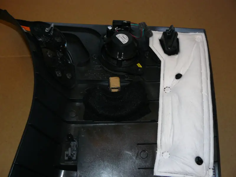

Once that stuff was out, I used some spray adhesive with some black trunk-liner material to cover the holes in the trim panel that would be left from the rear seat belts. The black liner was scored at a local car audio shop, but there are probably plenty of options with other colors as well. With the police version, the slots are just left open, but I wanted them covered. This is the view from the back:
One of the panels back in place showing how the seat belt slot is now filled:
