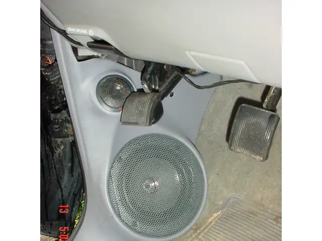

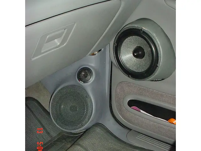

Sure. If you are allowed to view the pictures related to my profile, there are a bunch there. This was my first time fiberglassing pods (in the doors) and the kick panels I got from Q-Form. They're not listed for sale anywhere. Search this site for a thread I started with the word "kick pod" and you'll get some information on those.

Outstanding! Sweet install! The Q-form looks nice. I was inspecting the kick panels last night and the E-brake looks like it would be in the way. I will check out the other threads. Thanks!!

you gotta bend the e brake outta the way. i'd show you mine but i dont have any pics :rolleyes:
Yep, you'll have to bend the brake. I did it two years ago. No problems.
Karl
yea, if you use your ebrake alot it might suck...i never use mine so its cool.didnt realize yours was a stick, cool.
Great pic! So you really have to bend it.. in the name of good sound Yes! It doesn't interfere with the operation of the brake pedal?
yEa!
Yep. Mind you, I have a stick, so leaving it in first gear is almost enough. But the brake works fine. Also, you can shorten the cable to where you barely depress the pedal and the parking brake engages.... I wanted to go that route, but just found bending the pedal easier.
Karl
