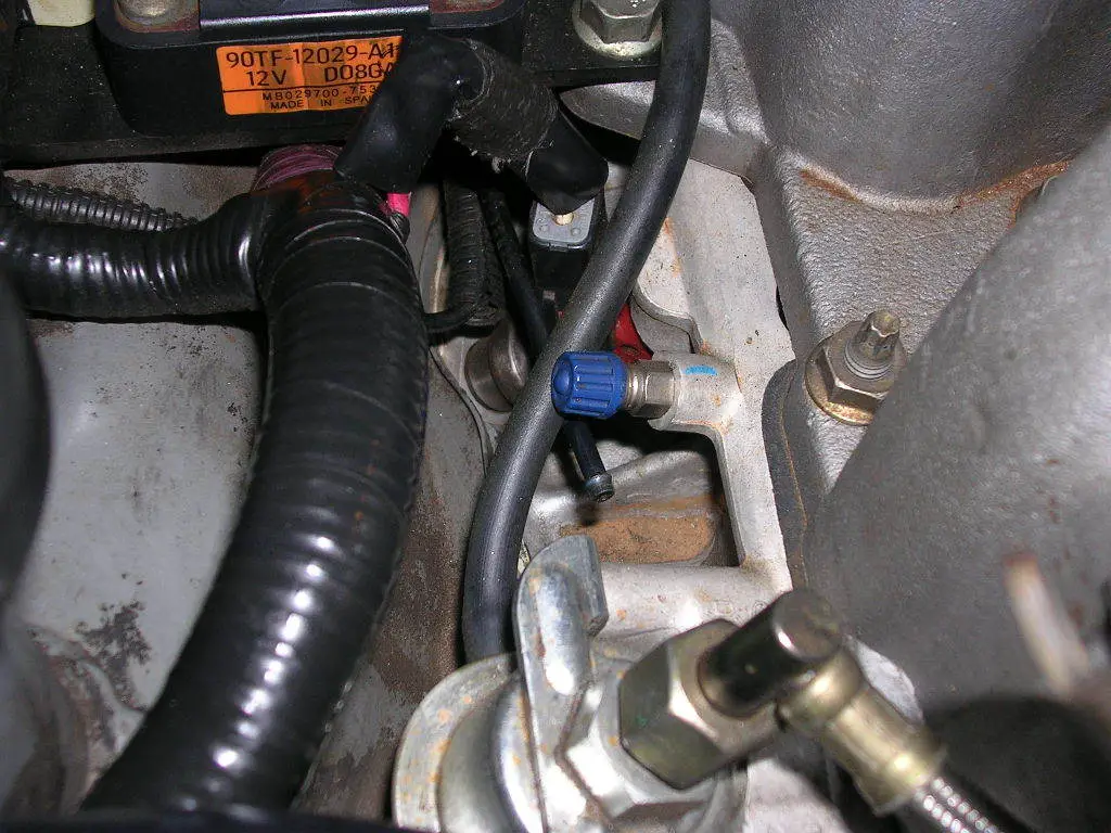

the only thing i can think of that your trying to describe is like you said ...the fpr .(round canister like unit with braided fuel line on one side and the bottom side of it had a small vac line going to it ) the only other item that can for see on that side of the engine that has a vac line hooked to it is for the climate contol system ( round oblong plastic tube that holds vac pressure) .

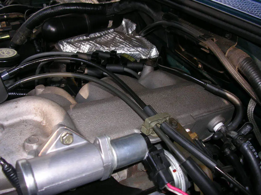

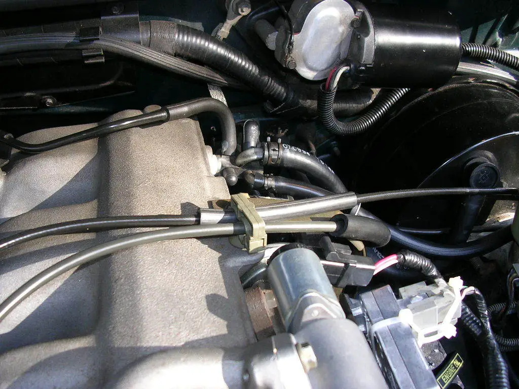

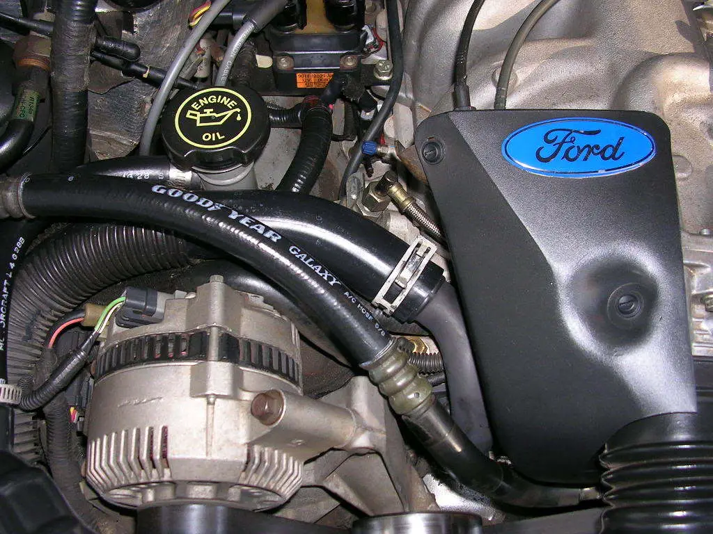

i know you said you had problems with your camera so i went out and took some with mine ...may help you help describe your problem .sorry for the big pics ...did not have time to resize them ...
