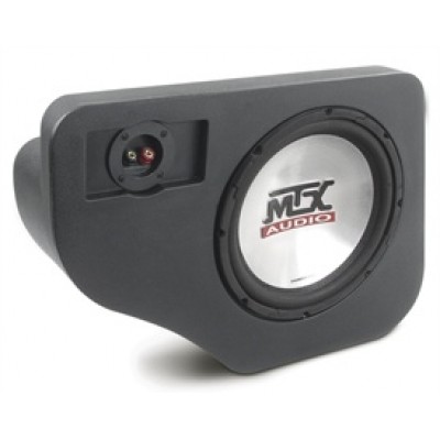

MTX audio also made a thunderform enclosure with a 10" as well.
