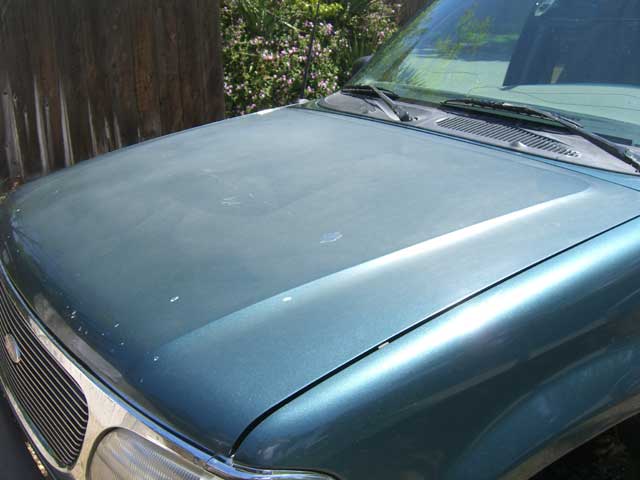

Since I wadded my truck up a loong time ago the body shop used some crappy paint. A couple years ago the hood started to fade.
Any easy fixes for this? Or is a whole new paint job in order?
Try some polish and or cleaner wax.
I recommend a cutting, then finishing polish. If it does not remove the "dead" clearcoat (hazed, oxidized, etc.), then it is the paint job itself.
To try a cheap option at first, check out the Meguiar's stuff at an auto parts store. For some heavy duty stuff, check out Menzerna (Intensive and Finishing) polishes. You'll need a high speed rotary or dual-action polisher; however, you may be able to get away with an electric drill with a buffer attachment, assuming you can manipulate the RPMs of the drill from between 1,000 and 4,000 (not sure how many drills do this).

I would wetsand, polish, then wax.
