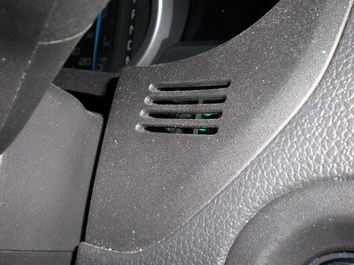

The noise you hear might be the small fan that runs to detect the cabin temperature. It is behind the small grille in your dash.
