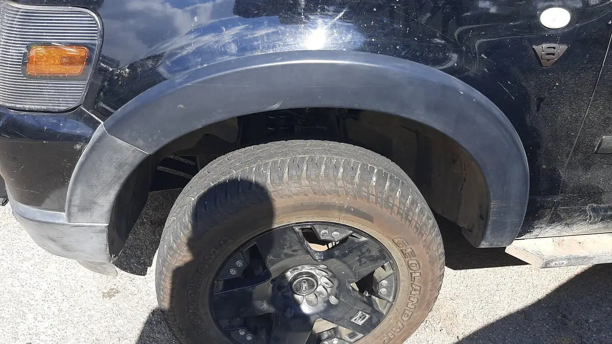

Hi all
I am trying to get the "wide" wheel base look without changing my rims (now i have minus 10mm offset rockstar rims).
Also my 07 XLT fender flares looking terrible (they kinda gray because of the UV)...and also acc. to local DOT laws i cant use wheel spacers or bigger size wheels
so... i am trying to ask someone with fender permanent removal experience.
How its look without fender flares?
What should i do with fender mounting body rectangular holes without the fenders installed?weld and repaint?

Actually this plastic moldings looks ok without UV effect.ive discovered that Gen 4 has XLS trim without wheel arc moldings.
Ill try to restore em with heat gun for the beginning
Heat blower gun effect:
Not really perfect but looks better

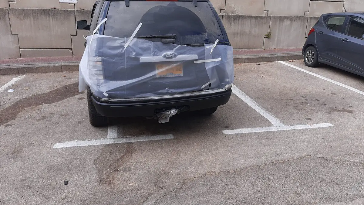

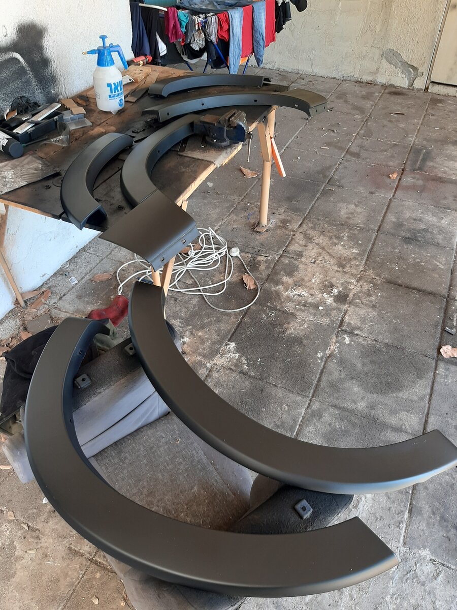

So today recoated my fenders with three layers of rustoleum black matte 2x ultracover.
Since ford outdoor TPO plastic parts already sold primed ,only proper surface cleaning action needed.
According to spray paint TDS for plastic parts painting about a week for the final curing needed.

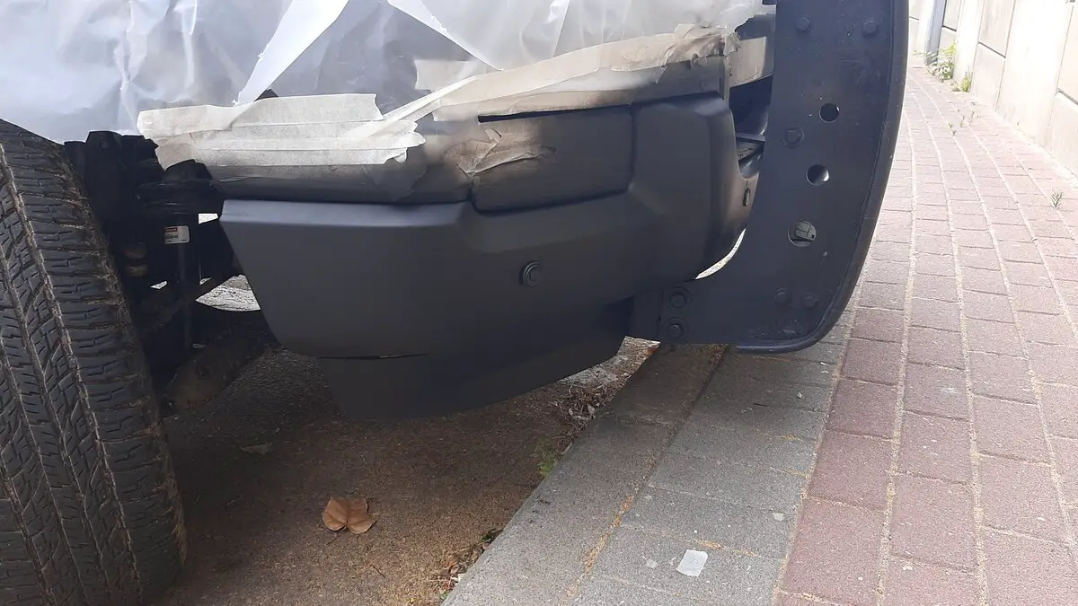

Bumpers painted (4 coats):

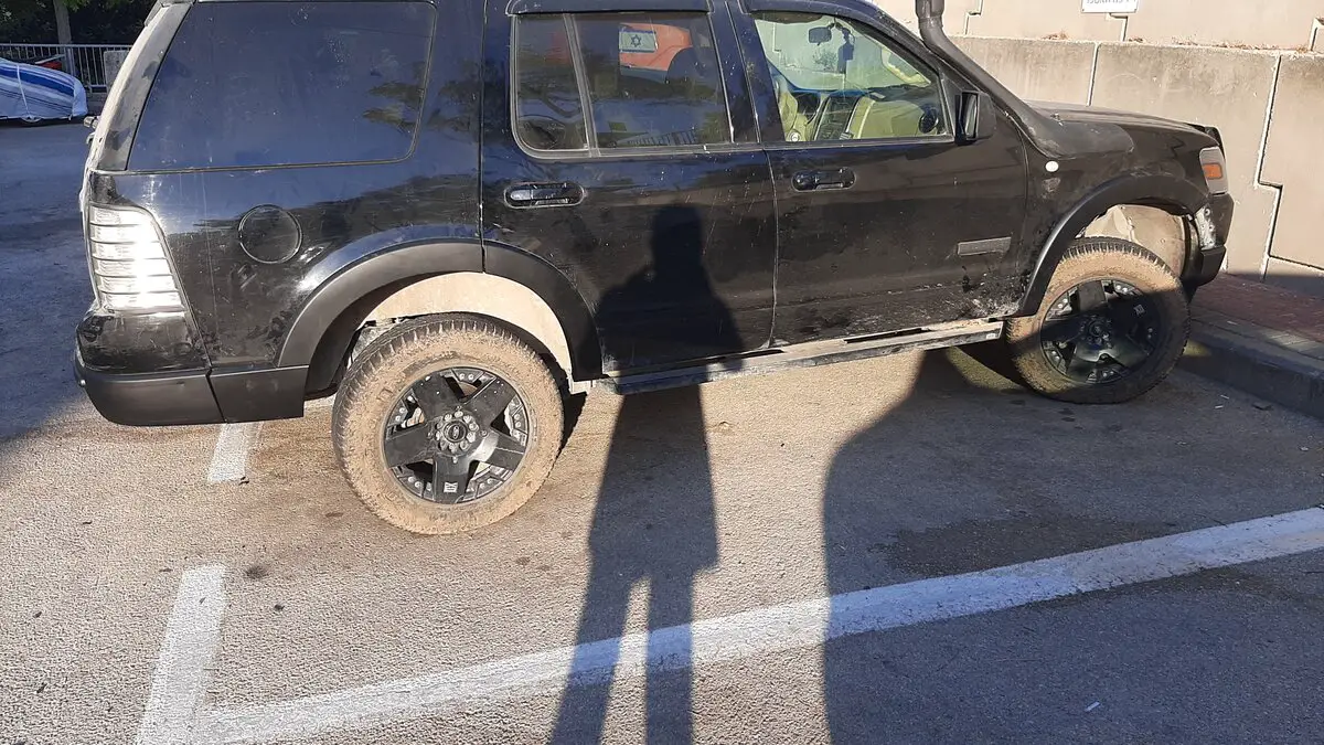

Final version(according to rustoleum specs after a week cure).ive no idea of color differences reason between rear bumper and rear wheel arc
