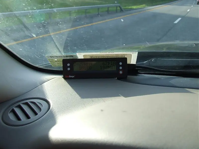

All is well now. Driving up to Lake George my intake air was same as ambient....ohh chilly chilly. The truck ran well and she no longer feels powerless.
