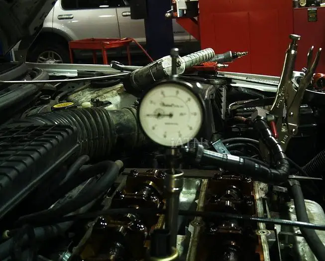

If you are doing anything timing related or doing a leak down test; it's always important to have certain cylinders at TDC at certain times with certain valves open/closed. Now, a tip for find TDC is to remove the spark plug and stick a long screw driver in the spark plug hole and start to turn the motor over manually. Do NOT rotate via starter/electrically. Once the screw driver is coming up and starts to move slowly down again, you are around TDC. It's ok to spin/turn the engine in a normal operation condition direction, but do not rotate in opposite direction of normal op - unless it's a small amount. May cause valvetrain to bind.
-Drew
Ps: you could also do it the dial indicator way for TDC:

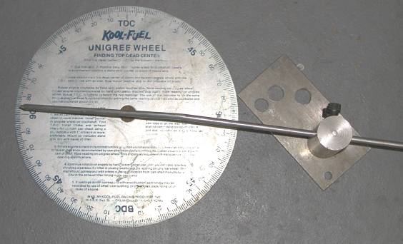

Ahh.. HUGE wave of nostalgia here. You will forgive an old man.... but back in the dark ages, when I was building engines.... and as a student also worked in the Astrogeophysics machine shop at the Univ of Colo. while I was in school (some of you have already been bored privately with my Mars Viking Lander bracket story)... I had a degree wheel and pointer setup.... reading this thread made me go dig them out of the bottom of one of my tool boxes.... wanted to share... or more honestly, wanted to reminiscence.
Here was the set up I used...
The degree wheel was a commecial one, but the pointer was something I made that fit what I was doing at the time...
Materials were cheap, and the equipment time was free.... I was in a learning mode... I wish I still had access to those tools... another view
I do not remember at all what led to this design, but the base fit several engines I was building at the time for a friend who raced...
The post was interference fit and pressed. Anyway here is one last view... maybe this will explain what we are talking about when we say "degree wheel"
