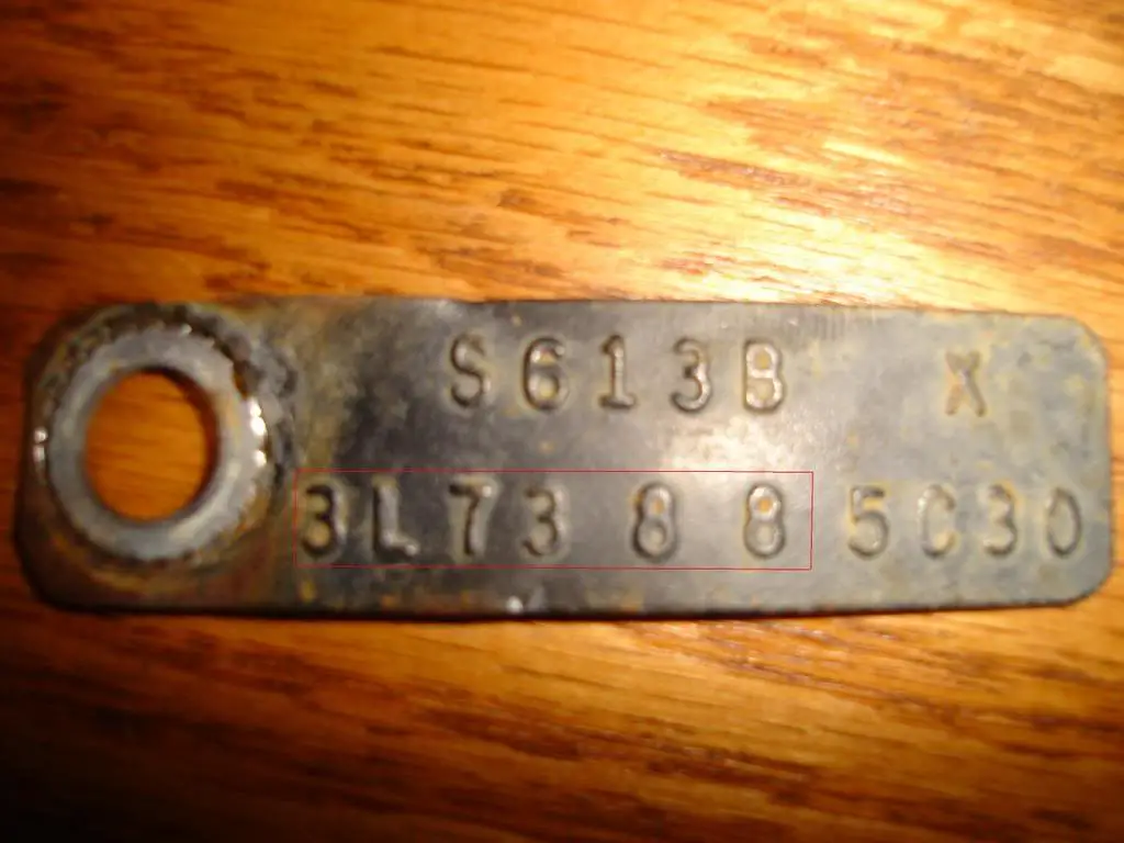

second, any diff from a 97 and up 4L or 5L truck will work/fit into yours. if you are not sure of the ratio, if you look on your rear diff tag it will have some numbers on the bottom line and read something like 3 55 8.8, 3 73 8.8 or 4 11 8.8. the first 3 numbers are the ratio. or you may have a sticker on the door that will have a axle code on it.

so i grabbed this from a google search so it may help you a little more
the first number and one number tell you your ratio on the bottom left
3L73, tells you its a 3.73 ratio, then 8 8 tell you the diff size
keep in mind, this is the rear tag. if that is on your rear diff, then you will be able to know what your gear is, and you will know what what is also in the front. i go by the diff tag more then the door sticker because sometimes the sticker is painted over, rubbed off, or you never know if the door was replaced with the same color of door from a different truck.
OK I found the tag on the rear diff and I have a 3.73 8.8 . There are some diffs on ebay that are from 4X4 explorers and they say they are compatible with the AWD explorers. This is not true is it?
a 95 and 96 v6 trucks are different. the were vacuum operated (they have a "knot" on the passengers side). otherwise any second gen explorer front axle that has 3.73's will work
