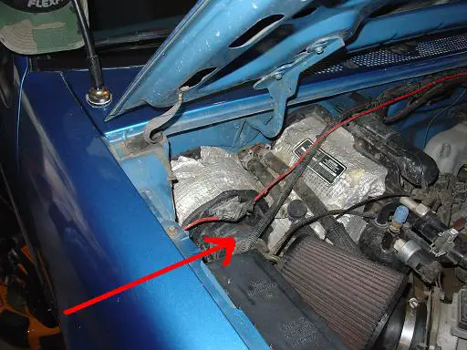

Next there is a watertight vent off the other side of the motor housing which is essentially a rubber hose with a loop of rubber which holds it tight into the vent hole by wrapping, elastic band-style around the housing, it needs to come off..

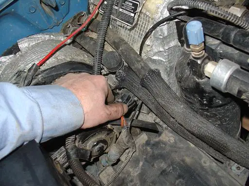

If you have Air conditioning, you will want to undo the electrical connector which enters the housing next to the heater fan..

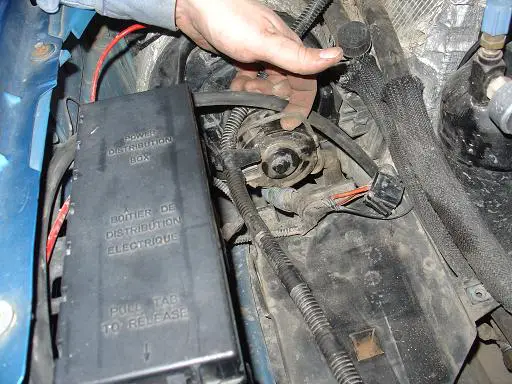

Now that room has been made, you need to undo three 5/16th bolts to get the motor and fan assembly out.
Then you can pull it out.

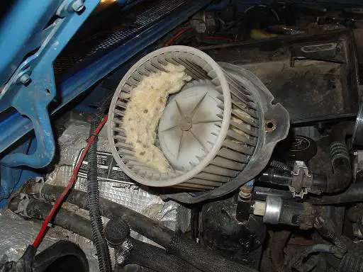

My fan had started making a rubbing kind of out of balance sound. I found a bunch of insulation in it. I suspect a mouse, although I saw no mice crap, and I can't quite figure where the insulation came from. Works fine again now.
It has made this noise since camping on a 4x4 trail, so it is quite possible that I picked up a mouse at that time.
