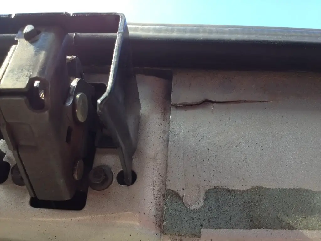

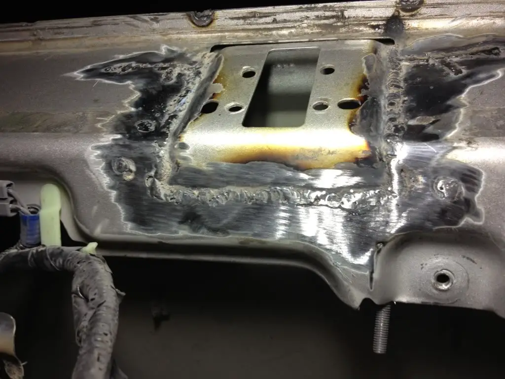

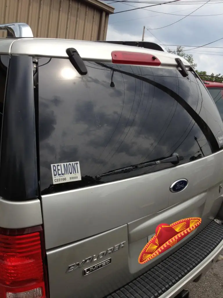

Broke my hatch from my audio system. Got it fixed pretty solid, I would recommend anyone who has this generation and any high powered or large subwoofer system to watch this very closely.

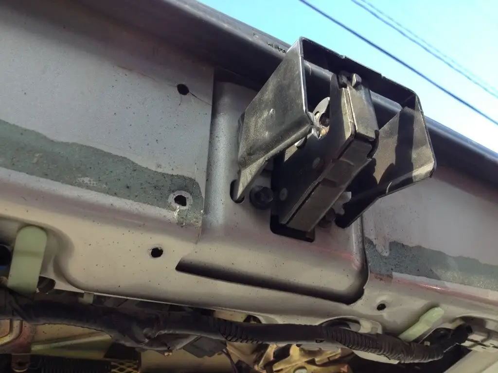

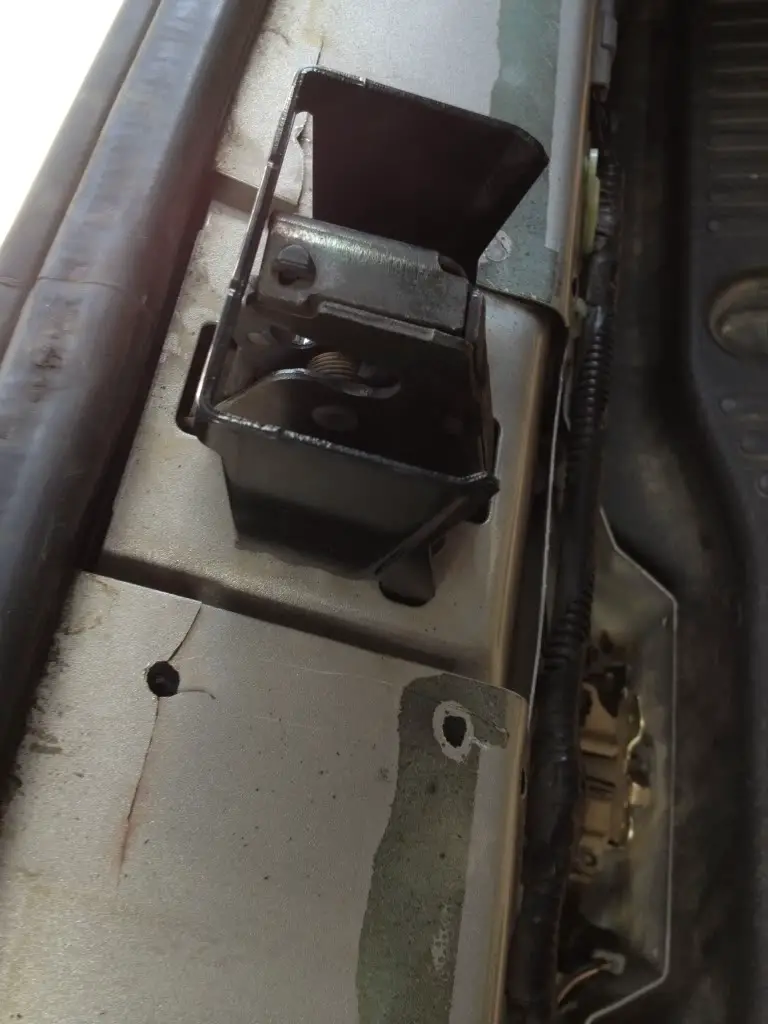

Broken:
Fix:

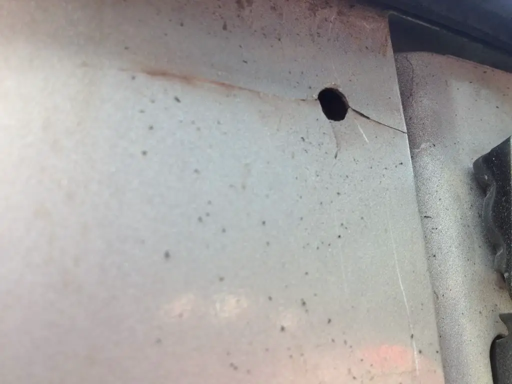

It was ripped in several other places as well, but they were minor. I have also sheared one of the bolts off that holds the rear glass in:

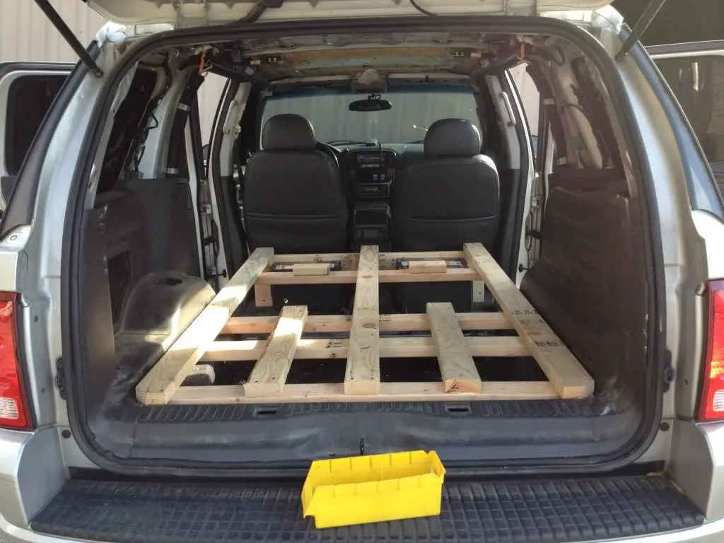

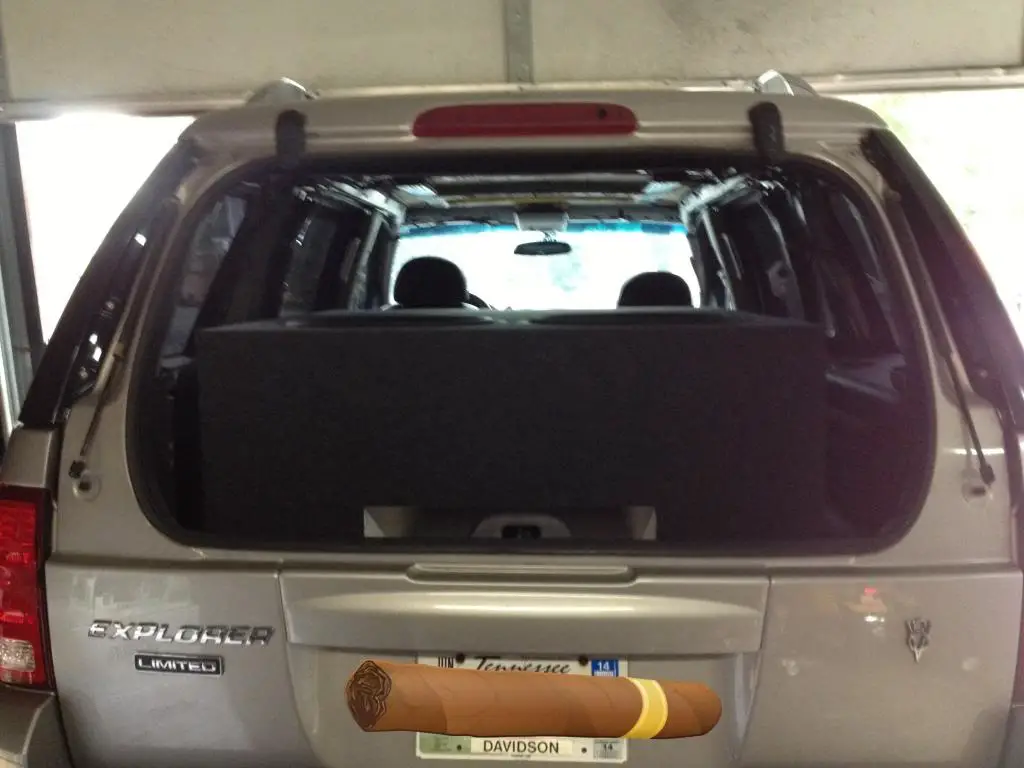

Box in the truck:

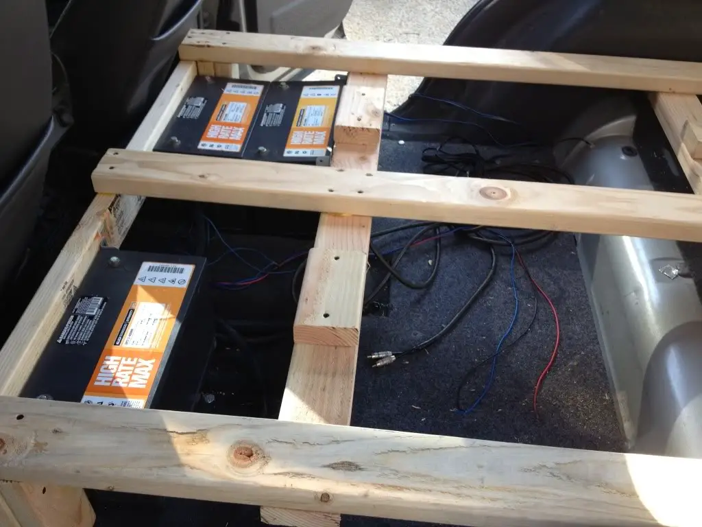

How it is currently (re-building in progress):
