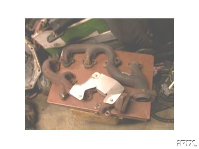

Yeah.. the heads are a little different, but both will home the same headers. Infact, I have '96 headers on my GT40P Heads. The EGR bung is the only problem.
Here is a pic of the stock GT40P manifolds (notice the bung in the lower left corner of the pic).

Here is the stock GT40 manifolds. (No EGR)

the pics posted there.. are you SURE those are correct? I have a GTP stamping on my heads, and my headers look like the 2nd pic section has posted there, not the 1st. I know this cos of the rathre obvious crossover on the driver side pipes on the 2nd cylinder.
I have a "bung" (I dont like that word lol) welded into the passenger side pipe right above cyl #3 on that side.
DarkFox - I know that they used the cast iron and steel manifolds throughout the GT40 and GT40P years. So either one could be on any Explorer. The main difference I was trying to show was the EGR "b*ng". :D
