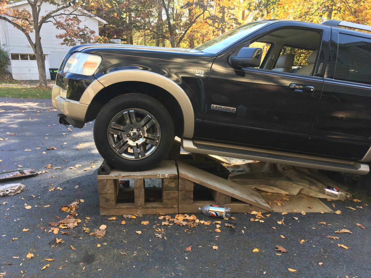

Used my home made ramps for safe work underneath.

I climb these ramps in 4x4 low, is that what you meant ?
Ramps, I meant very neat and much higher clearance achieve than the steel ones I have. Well done...

"2 thumbs up for your ramps, drop sheet/tarp and drain pan. May I suggest a couple pieces of angle iron as stops on the ramps? Would be a disaster to drive off the edge. How about wheel chaulks?"
I took your comments to my heart and bolted those rubber stops I found in my garage, thanks for the suggestion :)

And yes I did notice the stops on your ramps. My ramps are wimpy compared to yours.
