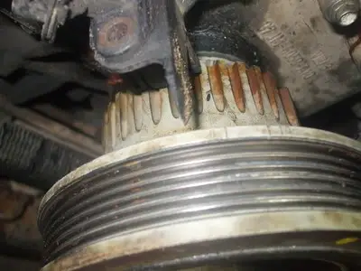

Firstly you must find TDC with piston #1 on the compression stroke. You will find a 0 degree mark on your harmonic balancer, line this up with the crank angle sensor bracket.

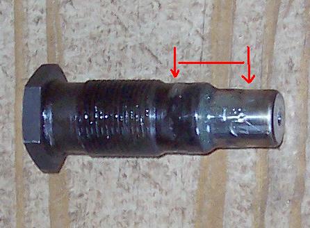

The right camshaft sprocket retaining bolt tightens in the counter-clockwise direction. The timing tool kit includes a tool to tension the timing chain (temporarily replaces the spring/hydraulic tensioner). If the tensioner tool is not used and the timing chain is not taught then when the camshaft sprocket retaining bolt is tightened the spring/hydraulic tensioner will compress allowing the camshaft sprocket to rotate relative to the camshaft unless the sprocket is held in position somehow. To check for accurate timing the timing chain must be taught (tensioner spring is too weak to make it taught) when the camshaft and the crankshaft are aligned correctly. One method I used to time my camshafts: I applied epoxy to the old tensioner so it couldn't move and used that as my "precision tensioner tool".
If you use this method I suggest using the old front tensioner instead of the rear. My rear one was just barely long enough to use in the front position.
