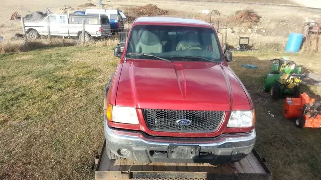

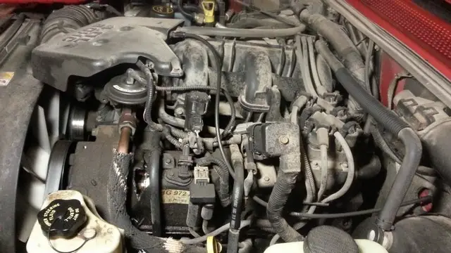

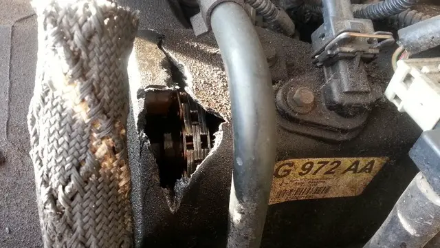

Well i drove to the next population center east of me 475 miles round trip the other day to pick this up. Rust free, (no salt in Montana) 2001 XLT 4x4 V6 Automatic, 105,654 miles. It was advertised as needing an engine. When i got there and looked at it there was a small hole in the valve cover over the timing chain. Looks as if the cam follower or tensioner let loose. I drove it on the trailer (had no other choice when the come-a-long broke)and it rand ok with a little chain noise that i expected but no vibration or miss. Just in case, i picked up a used engine with 66,000 from a rollover for $400. Figured i could always sell it again at that price. Anyways, i'm thinking i may be able to just fix the tensioner and everything else in the timing on the front and roll until something else lets go. (gotta pull the engine to do the back guides so i will forget that for now.) Chime in on opinions of the value as is and i'll post the price later.
Had a friend run the VIN this am. The tensioner was replaced at 34,000 miles in 03. The people i bought it from picked it up in 03 with 42,000 miles on it. Other than regular maintenance they never had it in the shop for anything. I'm thinking the Ford tech may have F-ed up on the install because he sure half azzed some other stuff. The reason i am suspicious is all 3 bolts for the coil pack that go into the side of the head by the exhaust manifold are missing. There where only 2 holding it on top. This has to come off to pull the valve cover. Also when i pulled the valve cover you could see it was reinstalled with dirt on the head. You can see where the rubber o-ring smashed the dirt onto the head. A good mechanic would have cleaned that. All of the wire holders where not snapped back into place either. Just all around shoddy work. Anyways here are some pics. Pulled a bunch of pieces out. Looks like the front of the engine has to come apart now.........

That sounds like the engine had a little rattle early on, and they only replaced the front timing chain tensioner. That is the most common thing for Ford to do back then, and it was needed badly on any 97-01 models, maybe longer. Those first models had no check valve installed in the oil galley leading to that one tensioner. On start up the tensioner would take a short time to build pressure to help the internal mechanical spring. That was the rattle so common on early models, and the plastic "straw" looking thing solved that.
Hopefully the owner didn't abuse the engine, and when it did finally have the chain cassette let go, they didn't drive it far. If that's what happened, you may be able to save the engine with just the front timing system rebuild. If so, the engine would be good for a long time, or until the rear cassette has issues etc.
Be sure to do the rear timing chain tensioner too, that one is super easy.

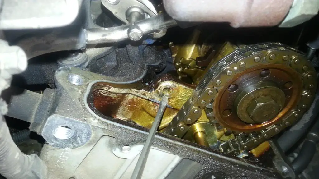

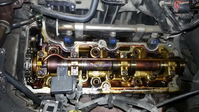

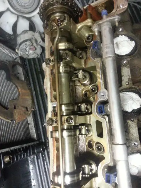

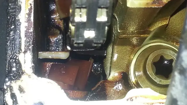

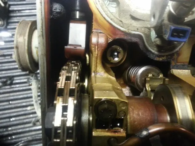

OK,, Change of plans. I think i have other issues. From what i can see from photos i have found on this site there is supposed to be a bolt here.

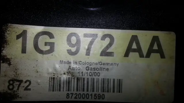

If that is the case it's in the engine somewhere. This means pulling the engine to find the pieces. If i'm gonna pull it, i might as well put the 66,000 mile engine in it. Here is the engine tag on the 66,000 mile motor. From the date listed on the tag can i just put in the upper tensioners or do i need to go through the whole thing as well?
Another question, The engine came out of a manual trans ranger, My daughters is an auto. Is there anything i need to be aware of for wiring Ect??
The timing work should be done to any pre-2002 4.0 engine, and every 100k miles, maybe less.
You can use any engine, just use the same type of external parts and sensors from the vehicle engine. No worries,
unused hole
That photo is of the front of the left cassette. That hole is not used. There is no bolt missing. See photo below.
Don't spend time looking for a bolt that isn't missing.

Good catch Dale, I didn't notice that it was that bolt hole.
The two heads are manufactured to be identical, and then they are used for each side with some different parts. So there will be a hole or two like that one that is not used.

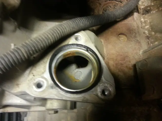

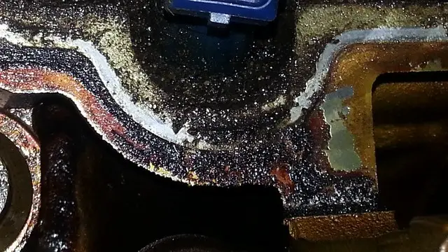

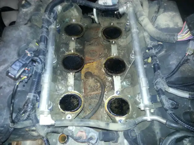

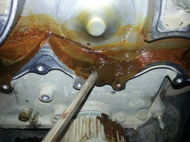

OK, Pulled down the 66,000 mile motor and was worried at 1st but now i don't know what to think. There was some sludge, kinda orange color in the t-stat housing and behind the water pump. Here are a few pics.....

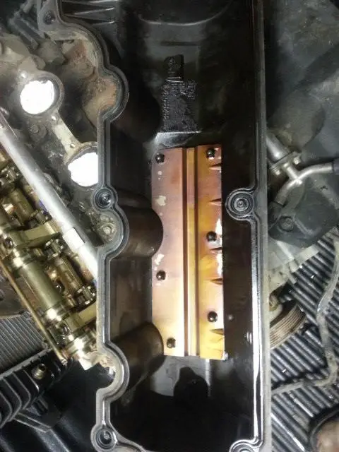

But when i pulled the valve covers the inside of the engine looks spotless! The one in the truck has oil leaks all over with 105K on it, this one is spotless. I am going to continue with replacing the timing components but wonder if the chains and sprockets need replaced too? Also gotta find out the side of the bolt holes so i can pull off the harmonic balancer. I have bunches of different bolts for my puller but i believe all are SAE not metric. I know someone posted the size in one of these threads. Any thoughts on my plan are MUCH appreciated!

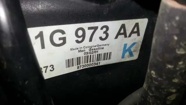

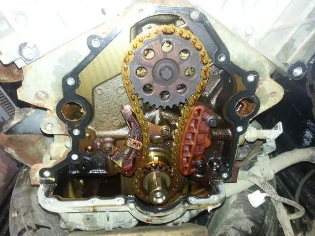

So i pull the balancer a few minutes ago and get the cover off and no balance shaft! Doing a little google searching it looks like the rangers never came with one? This is an 02 engine out of a wreck 4X4 ranger..............
check the block VIN
I suggest that you check the block VIN on that engine. It has the old style primary tensioner that was supposed to be replaced by the improved one in 2002 and later engines.
The tenth digit of the 17 digit VIN indicates the year of manufacture. The identifier changed in 2001 [1998(W), 1999(X), 2000(Y)------2001(1), 2002(2), 2003(3)]

My bad. Either i fat fingered the keyboard or just messed up period but the engine was manufactured 3/2/01 Going through the parts list thread has confused me a bit. Here is what i have so far:

The left and right guide assemblies are no longer available separately. You will have to purchase the entire cassette (sprockets, chains & guide assembly). If you replace the chains you should replace the sprockets and vice versa due to wear patterns. Some members have saved money by purchasing aftermarket kits containing most of the timing parts. See: SOHC V6 Timing Chain Parts Sources
Be careful not to damage the camshaft oiling tubes. They bend and break easily if struck. The "sludge" behind the water pump may just be accumulated rust after sitting for years. Check the water pump impeller and bearing.
