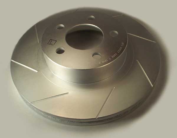

Here is a picture of the AWD / 4WD style.

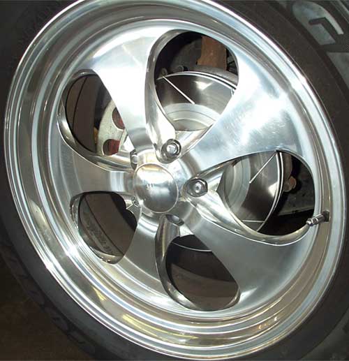

Here is a picture of our slotted rotors as installed on a 2WD.
