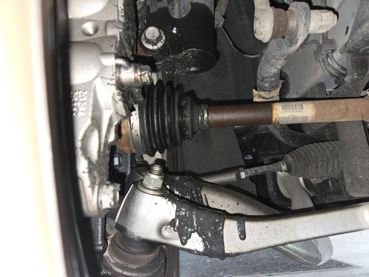

After my 2020 explorer back from Ford for its an oil change at 35k yesterday, paper work said leaking drivers side axle boot. This car is a pavement princess driven by my wife and myself only. I thought no way could it be torn at 35k miles so I crawled under and had a look. Found this (see attached).
The car is CPO but the bumper to bumper warranty has aged out. Will the 5/60 powertrain cover this repair at no cost? Of special interest to me though, is if I show them the TSB for front electronic differential that involves them basically deleting the on electric demand AWD clutches and make it AWD all the time, would they do it since the CV axle has to come out anyway? I think that would give me better long term reliability since they tend to leak beyond warranty and are expensive to R&R.
Axles are covered under powertrain. Axle boots should not be failing left and right--they are defective and Ford should have recalled them. Both Left and Right will fail prematurely for MY 2020 and most MY 2021.
Replacing an axle take about 30 minutes for the drivers side and about 45 minutes for the passenger side. Replacing the FADA probably takes 6 hours, so no, they are not going to do a the TSB. And if there are no codes or evidence to support a problem existing, Ford dealers generally NEVER do work under warranty... TSB or no TSB.

Unfortunately this is a common problem. The drivetrain warranty will cover it though.

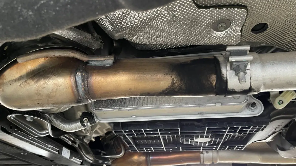

Same problem, bad CAT. Did you check for a CAT recall? 8yr or 80K emissions warrant but if your VIN matches a recall it is covered. Look under the veh for black leaks at the connections.
What were the catalytic converter symptoms? I swear mine sounds like it's got an exhaust leak when started cold but goes away when warm. My focus is the same and has been that way for 80k miles without issue so I was thinking it's just how the DI motors sound when cold. If it's a leak, I assume the emissions warranty covers that repair?
The welds on the cat converter pipe (many refer to as downpipe) fail. You will hear the exhaust sounds become louder or smell exhaust fumes. I had neither and was simply under the car doing another repair and noticed the crack in the weld. The flex section have been known to fail also so you can hear and smell exhaust from that too! There is a recall for it but strangely enough, it specifies only the LH cat pipe--even though people have had both fail. The cat pipes should be covered under federal emissions but as someone with 90k miles on their MY2020, those limits go by quick. If you suspect it, get it checked now--preferrably by yourself. After I noticed the crack in the weld, I brought my car to the dealer--to my shock they said everything was fine!!! I showed the service writer the pics of the crack and only then did he order the cat pipe.

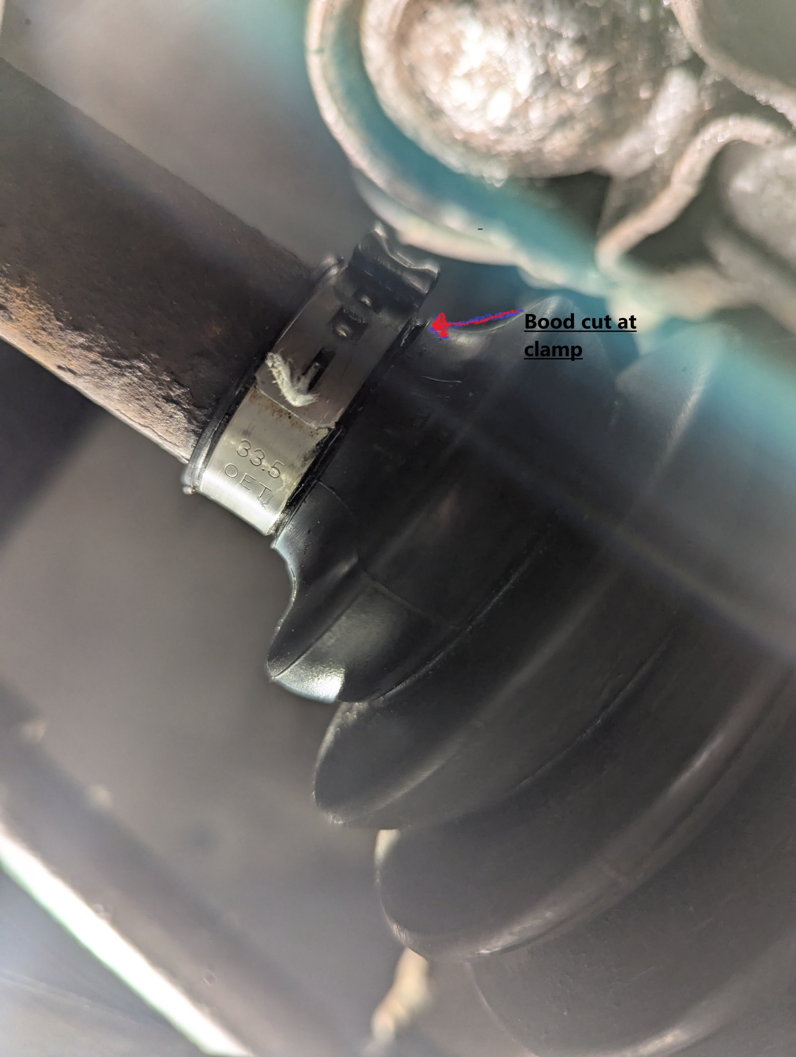

Have a 2021 Ford Explorer Platinum about 48,000KM, was doing a brake pad change and noticed grey grease everywhere. Tear was in exact same place as photo. Will bring to dealer and see if under Power train warranty. Have a 2009 Buick enclave still and never had any CV axle or boot problems.
Welcome to the Forum. :wave:
Check your Warranty Guide as to what's covered.
Peter
Will drop by the dealer where I baught it new tomorrow and see what the service people say & report back, have photos to discuss with them.
Explorer braught to dealer where I gave multiple images. They said they would cover under 5 yr 100K drive train warranty. I had put a small amount of rubber flex seal around where small clamp boot was torn to stop spraying of grey grease as I was worried the spraying everywhere out of the CV axle boot was going to get on the brakes. Had many pictures of grease everywhere and of cleaned up boot to show where it was actually torn to show dealer. Image of cleaned up boot to isolate location of tear.
