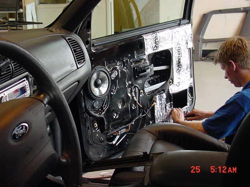

Im trying to get a component system for the front door speakers of my 97 xlt and i found this sweet deal on new 6 1/2 infinity component system but was wondering will that fit the door or will only 5 1/4 fit?? thanks!!

I put in 6 1/2 components in the front. I bought a pair of plastic 6x8 to 6.5 Metra adapter plates ($15 - part 82-5600) from Circuit City. Three screws went through speaker into factory plastic mounting plate. One screw did not line up so had to drill a new hole. No problems. The more time consuming part was attaching the crossover box to the door and have the door panel fit over it nice. To allow for repositioning I found it easiest to mount a piece of thin wood bigger then the crossover, then attach the crossover to it. I suppose I could have just drilled through the metal door a couple of times, but didnt feel getting new drill bits.
Yup, buy some adapter plates or make your own and the 6.5s will drop into the door easily.

A 6.5 will fit no problem! I have the RF Fanatic Q's in my doors and rear. Sounds great and Good luck!
