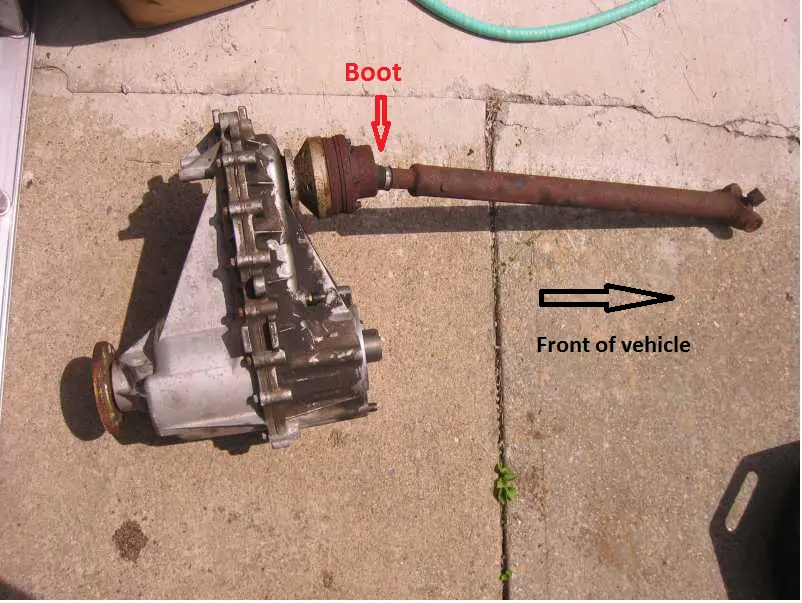

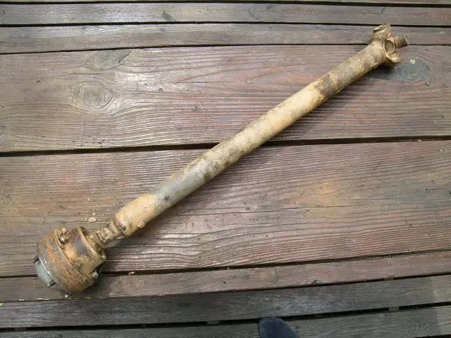

This is what your driveshaft looks like - minus the mud:
This is what your transfer case (BW-4404) looks like with the driveshaft bolted to it:
The "boot" isnt so obvious sometimes, especially when the driveshaft is caked in mud, but if you push/pull the center of the driveshaft towards the CV, you'll see which part is made of rubber.

Thanks to IZwack for the stock photo.
Your engine drives the transmission which is bolted to your transfercase which will have 2 driveshafts, one going back to the rear axle and one going forward to the front axle.
The front axle will have 2 axle shafts coming out both sides of it with 2 cv joints on each.
The Front driveshaft will have a cv joint nearest the transfercase (your missing boot location?) and a u-joint on the side nearest the axle.
The rear driveshaft will have a double cardan style set of u-joints nearest the transfercase and a single u-joint nearest the axle.
