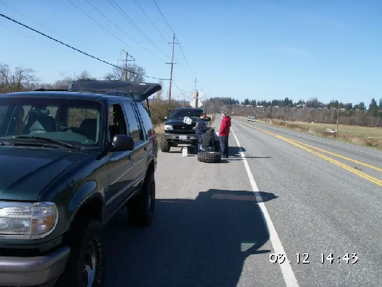

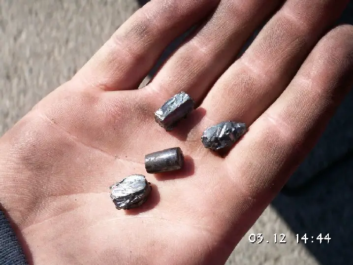

if you know your bearings are going, i wouldnt sit there and do nothing about it. Its damn dangerous when they finally go. And you'll be on the side of the road waiting for a tow
