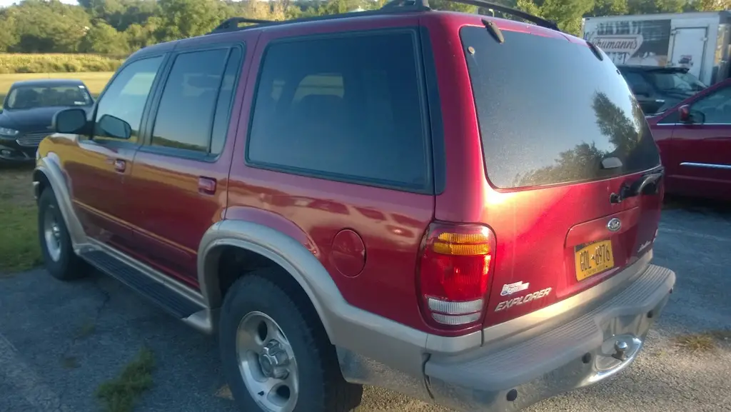

Just picked up a 99 EB 5.0 that is in need of a front pinion seal so I can get it on the road. I am thinking it would be a good idea to change the yoke as well as the seal so I can eliminate the possibility of a leak. I am having difficulty finding a company that sells the Yoke and the seal. Does anyone have a recommendation for a place to get both from. I have a D4 (3.73 LSD) front axle.
Thanks in advance, Pic of my $650.00 special
