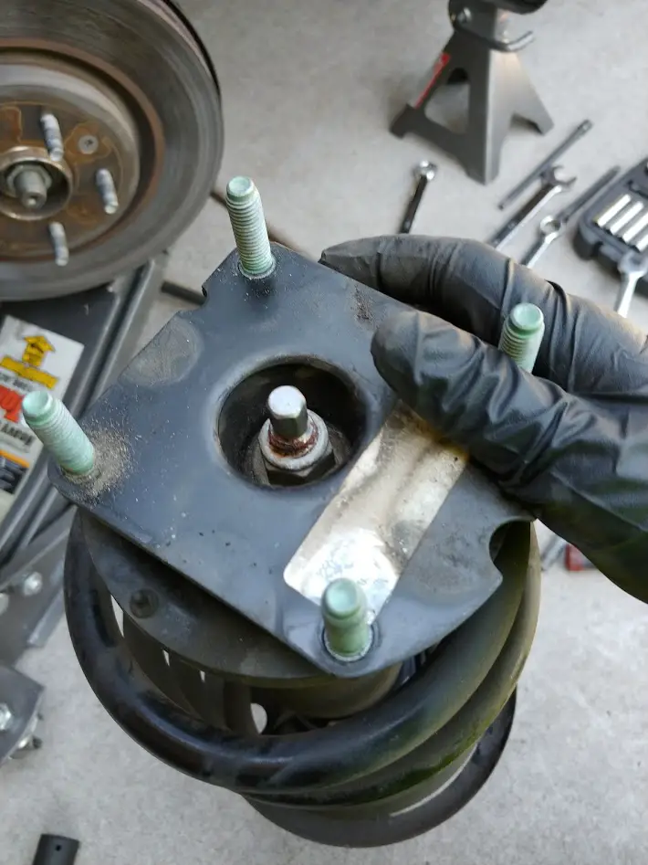

Are you referring to the notch on the strut mount? If so, the rounded side with the notch in it goes toward the outside of the vehicle.
I just replaced my upper strut mounts today. Here's a pic.
FYI, one good way to tell the orientation of the part is to stick your head up in the wheel well and look for the outline of dirt from the old part.

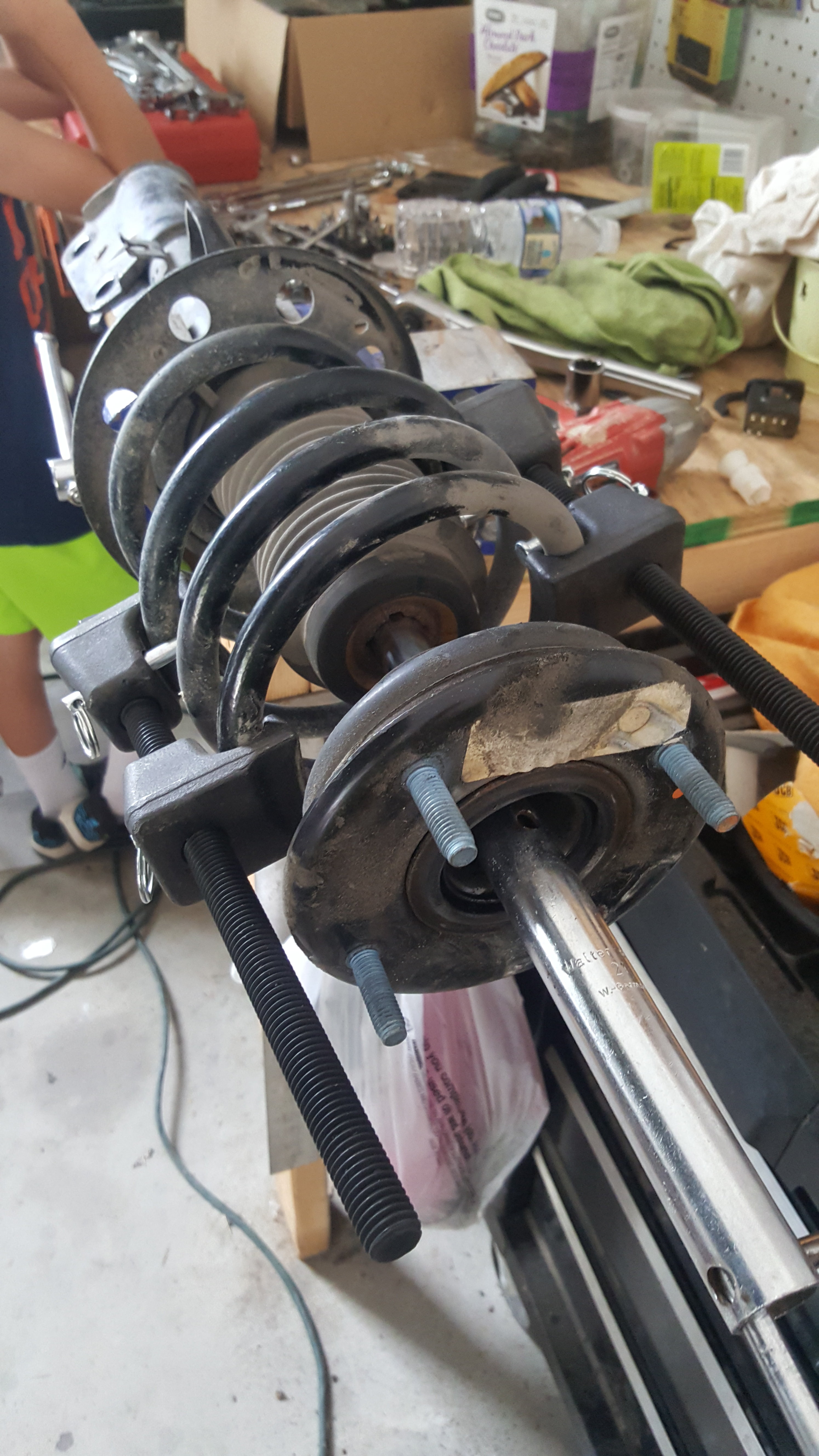

Asundine, appreciate the info. My strut mounts are completely round as you can see in the pic. The notch is very small and can't see it in the pic. Because of that, looking at dirt outline doesn't work.
I believe the "wrong" orientation will make it a 0.5 degree camber.
