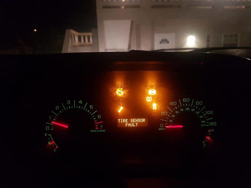

its a 2007 ford explorer sport trac v8 4x4, yeah its kinda only reving up barley moving here is a pic of the dash board the night it happend

its a 2007 ford explorer sport trac v8 4x4, yeah its kinda only reving up barley moving here is a pic of the dash board the night it happendView attachment 164580

A major ABS fault can cause "Forced Engine Idle". If that fault is a temporary issue, it could explain why "........when it happens......". Need codes. Badly. imp
It could be the front bearing going bad and cause the abs sensor to not read properly. Mine did that in traffic and wont move until I removed the abs fuse
it could be did your traction light came on also, mines came on and once i pump the brakes it will free up a little for me to drive and ill have to keep tapping the brakes to keep it going

OD OFF light does not comes on only the traction light and brakes get hard but im able to pump the brakes a few times and im able to drive it for a short period of time i had to keep pumping the brakes to make it home dis afternoon
