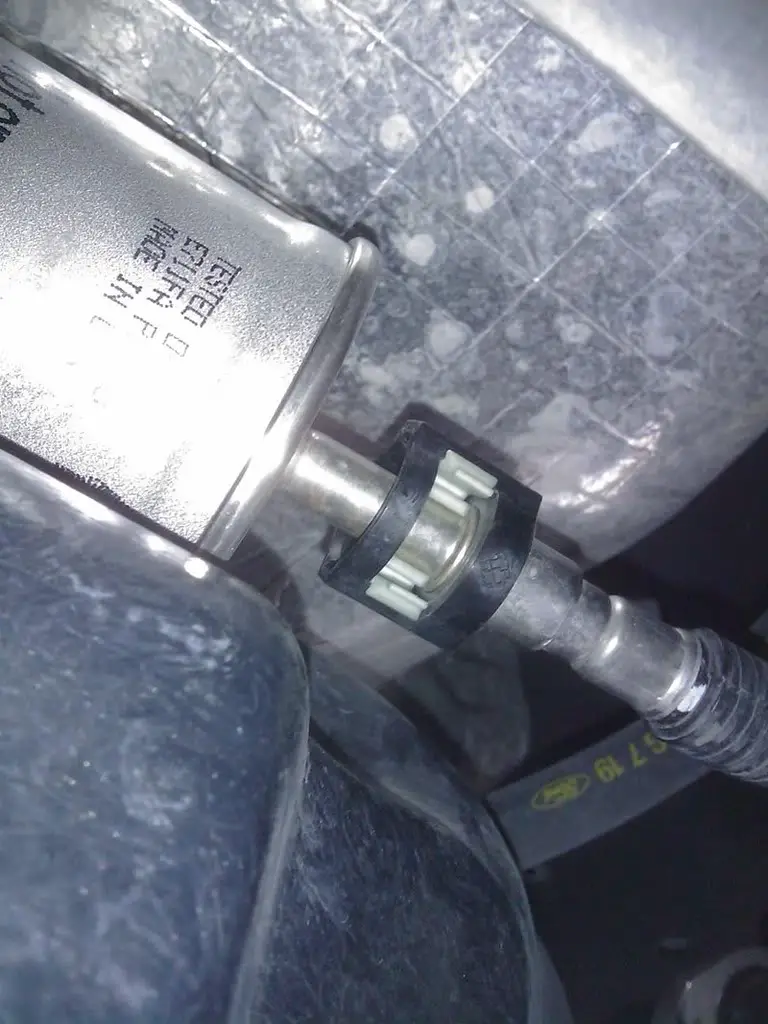

On a 2007, the clip should look like this:
I have one of those... thats for the black/grey connector with the two tabs right?

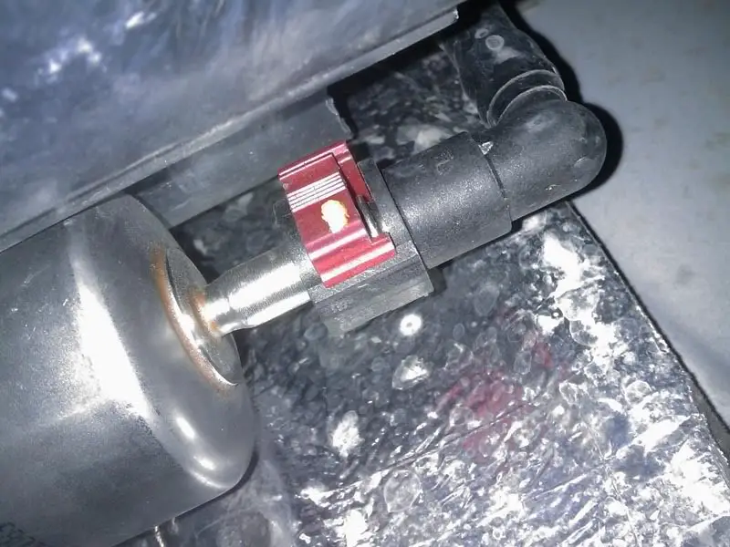

What about the other connector that is black/red larger single tab?
here are the two clips...
The tool I have is just a clamping tool (round and is used for various size hoses/lines).
Dude, you just saved me hours of misery. Thank you. :):us:
dont lose the red clip because nobody sells it and you will be walking for a long time
edit 4-23-16... just did the filter on mine and I have to say worst design ever.... good thing I found my disconnect tool because I though you didnt need one and after fiddling with the red clip for over an hour I tried the tool and the line just slipped right out
