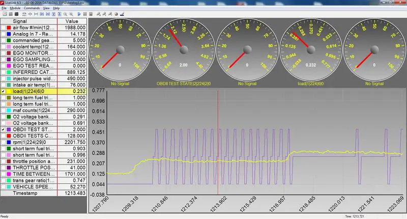

Fuel pressure to 54.96 (55 psi)
I raised my fuel pressure to 54.96 and entered my corrections to the injector data. First test drive I could not get the HEGO test to run/pass.
I did notice a characteristic, if the load was lower (20-25) it seemed like it was going in then going right back out of the test. I was watching OBD Test State, it is 1 when not testing and goes to 2 when testing starts. At loads around 20-25 it would go to 2 and back to 1 real fast.
At higher loads around 35%, it would stay in "2" longer.(test was running longer and being kicked out)
If it did not pass it would go back to 1, if it passes it goes to 4 and stays there and the OBD tests complete goes up by 32(number for HEGO Test run/pass).
I adjusted the MAF transfer Function after doing a step test and gave it another try, the test ran and passed but it would only do that on the highway. I could not get load high enough (35) on the back roads. So it seems to want or need load to be around 35%. Of course changing MAF and/or injector data changes the calculated load value.
I must note that I stopped adjusting engine displacement to make load read 20 at Idle, after reading that it should not be done anymore. I did do it in the past. I figure that the statement may have been made when considering newer vehicles with drive by wire and Variable camshaft timing. Changing engine displacement might make it hit higher loads(35) at lower speeds if needed at some point, assuming that will help get this HEGO test to run/pass.
So I have got this thing to run/pass the HEGO tests with fuel pressure at 54.96. I am going to adjust the transmission shift points again to try to get it to go into 5th sooner and run the test at lower speeds. I also need to see where injector duty cycle is at WOT. (With all this information I can't help but think that I could put the 60's back in and get them to run/pass).
Pictures showing where load is vs HEGO test running/not passing/passing.

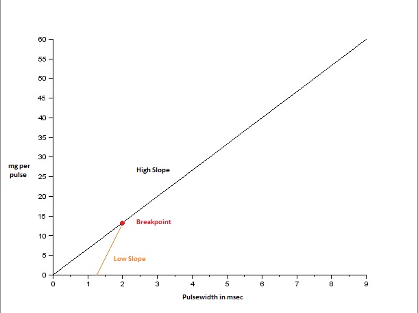

Offset multiplier
I realized that I've tried changing high slope, low slope and breakpoint but never experimented with offset.
If I shift the above plot left the PCM will think there is higher flow and reduce the pulse width resulting in a leaner lambda. If I shift the plot right the PCM will think there is lower flow and increase the pulse width resulting in a richer lambda. I may try changing the offset multiplier (FNPW_OFFCOMP) and see what happens.

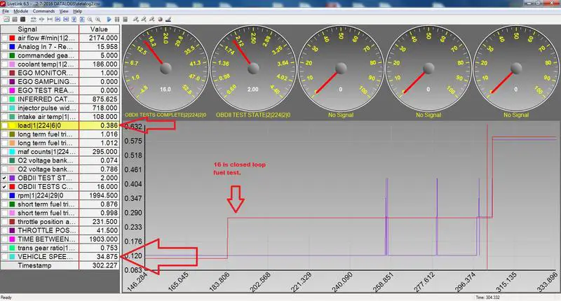

Scaled Engine Displacement/Inj Data to Raise Load
Load was 14, wanted 20% so 14\20 = .70
I scaled engine displacement and the injector data by .7
Without even dialing in the maf, the HEGO test ran/passed at about 35 mph in 5th gear on a back road.
STFT was adding fuel, it was not near 0% like it should be. Some things to note were that test 16 ran real fast.
16 is the test for fuel trims called the closed loop fuel test. I think when STFT and LTFT is near perfect it seems to take longer to run/pass 16. It wants to make sure Fuel trims don't exceed these limits:
Lean malfunction: LTFT > 25%, STFT > 5%
Rich malfunction: LTFT < 25%, STFT < 10%
Also STFT cycled around .90 during the HEGO test instead of around 1.00, I believe that was due to STFT being there when it entered the HEGO test.
This kind of shows that having the A/F perfectly dialed in is not absolutely necessary to run/pass the HEGO test.
Time to go step test and start dialing in the MAF again, then it's off for a WOT run to see where duty cycle goes.

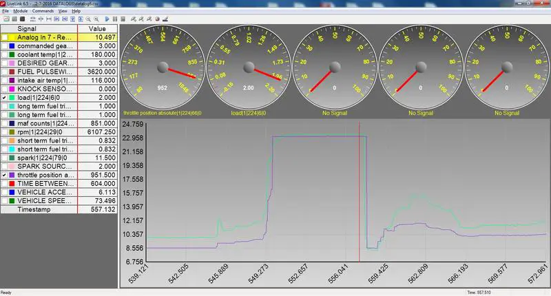

Pegged Load at 200%
Well, the scaling didn't work so good after all. I pegged load at 200%.
I will have to scale down, and dial everything in again. lol.
At least I am having fun experimenting and may be able to get those Deka 60's to work, after getting through inspection with these 47's I have two years to get them to work. lol.

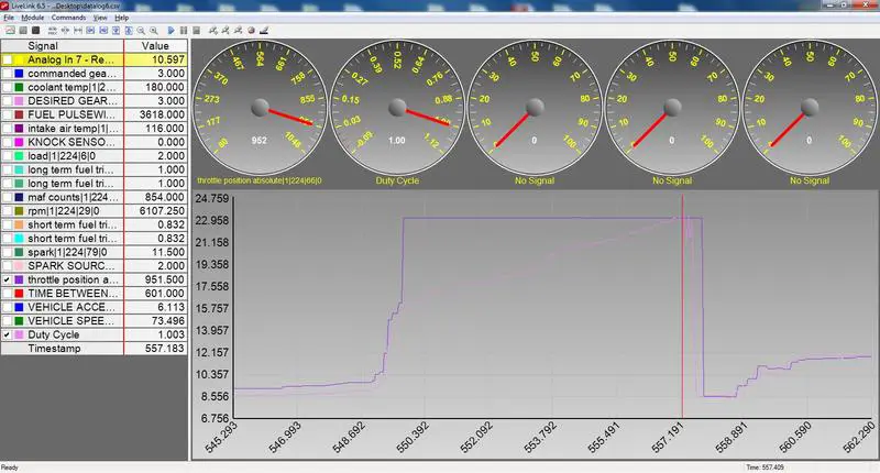

Duty
To top it off I pegged the Injector duty cycle too. Whoops.
And this is with fuel pressure set to aprox 55 psi, key on engine off pump running.
