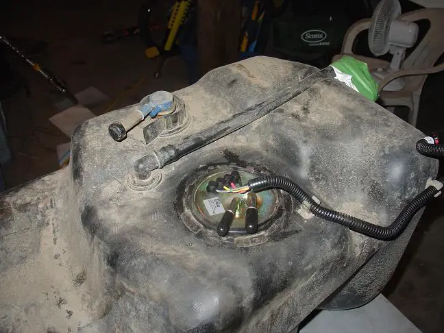

Here is a better pic of the top of my 1st gen gas tank. The line on the right is your send line from the pump, it is the larger diameter line. The other is a return line.
The metal tubes can corrode, mine did anyway. I noticed it smelled like gas all the time.
The ring that holds the assembly in on mine was so rusted it disintegrated when I took the old one out. The new assembly did not come with that ring, so I had to buy separately.

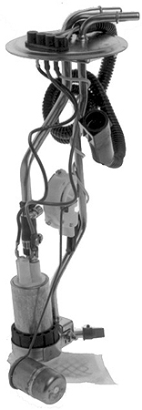

The sending unit with fuel pump installed is pictured on the left. The sending unit is made of zinc coated steel which holds up fine inside the tank, but the tubes outside the tank often rust out because of their exposure to the elements. Anyway if you need to replace the sending unit it would be easier to get the whole assembly (sending unit, fuel pump, fuel pump filter/strainer). IMO and as the others have mentioned it isn't worth the few $ savings to re-use your old fuel pump.
