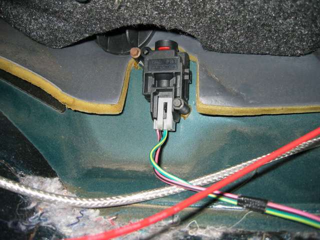

I would just like to add some additional troubleshooting info In case others come across your thread.
To confirm the pump is no longer getting power check the fuel pump inertial switch located below the glove box. Pull back the carpet behind the glove box and find the fuel pump inertia switch (pictured below). Use a meter (or test light if thats all you have) and connect either wire of the switch to HOT, and then ground the meter to a suitable ground. The meter should read 12v when the fuel pump is running and ~7v when its not.
As you may already know the fuel pump will only run when given 12v... When you turn the key from run to start the inertia switch (pictured below) will see 12v for only 2 secs or while the tac registers > 0 RPM. After 2 secs of zero RPM the computer will shut off the fuel pump relay and you'll only see ~7v at the inertia switch and fuel pump. Seeing 7v is weird but that is what you'll get if you check the wiring.
