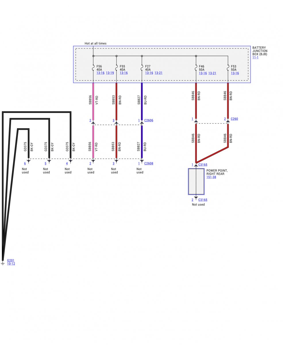

The Upfitter's Manual says that the 6-pin connector has three 40A fuses, in Battery Junction Box positions 40, 16 and 6.
The diagram in the manual (page 2-119) doesn't SHOW #40, and on my 2016, putting a fuse in #16 didn't put power into the plug, and #6 doesn't seem to actually have any contacts!
Since had the 6-pin plug in use while on the job, I know that there are fuses SOMEWHERE.
