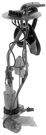

The fuel pump and sending unit assembly is pictured below. The Float at the bottom connects to the fuel level sensor (located in middle of the unit).
I colored the wire you are looking for in yellow because I think thats what color it normally is. The connection circled in red is where I would check first to see if it is loose, if not there then check the output on the other side of that connection. You may wonder why there is only one wire, and that is because what would have been the second wire is just sent through ground, which is another thing that could be bad.
