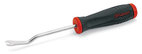

I have a bit of a stupid question, how do you get those round circular clips off the trim without breaking them in a 1993 Explorer Limited with the JBL 4.1 system in it? I'm gunna remove the entire JBL system. Also which kick panel in the interior speaker amp in and how do I get to it?

I removed all the clips using a Snap-On ASG-185A that my Ford neighbor loaned me. Worked great, and zero broken clips :thumbsup:
use the tool pictured above (or something similar from your local parts store). the interior and sub amps are side by side behind that passenger rear panel
I made one of those tools out of an old BBQ/Serving fork. I trimmed the teeth down to about 3/4" and rounded off the sharp edges to prevent damaging the panels.

Thanks for the replies everyone. Found them. :D
