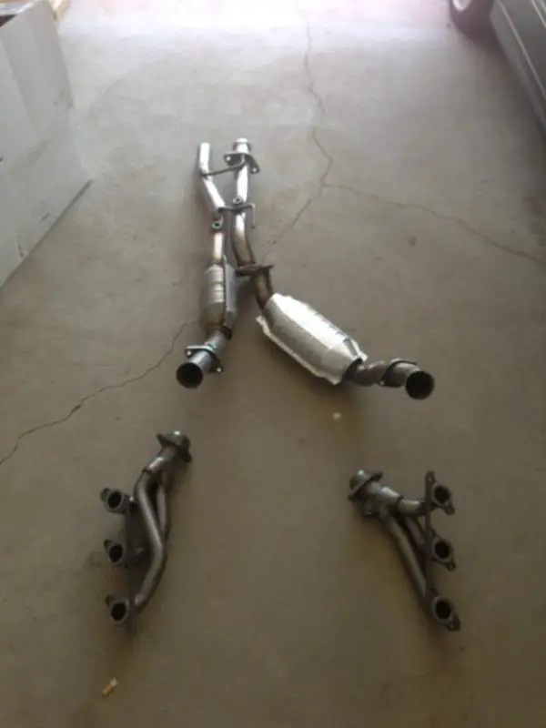

Recently received my Gibson stainless headers and Magnaflow cat setup for my truck. They've been installed but I'm away for work at the moment, pre-install picture below:

Do you happen to have the parts# for the gibson headers? When you get in town, please post a video (if able to) of the truck running. I am really tempted to order some of these and replace the cats as well with some Magnaflows. Thank you in advance!
