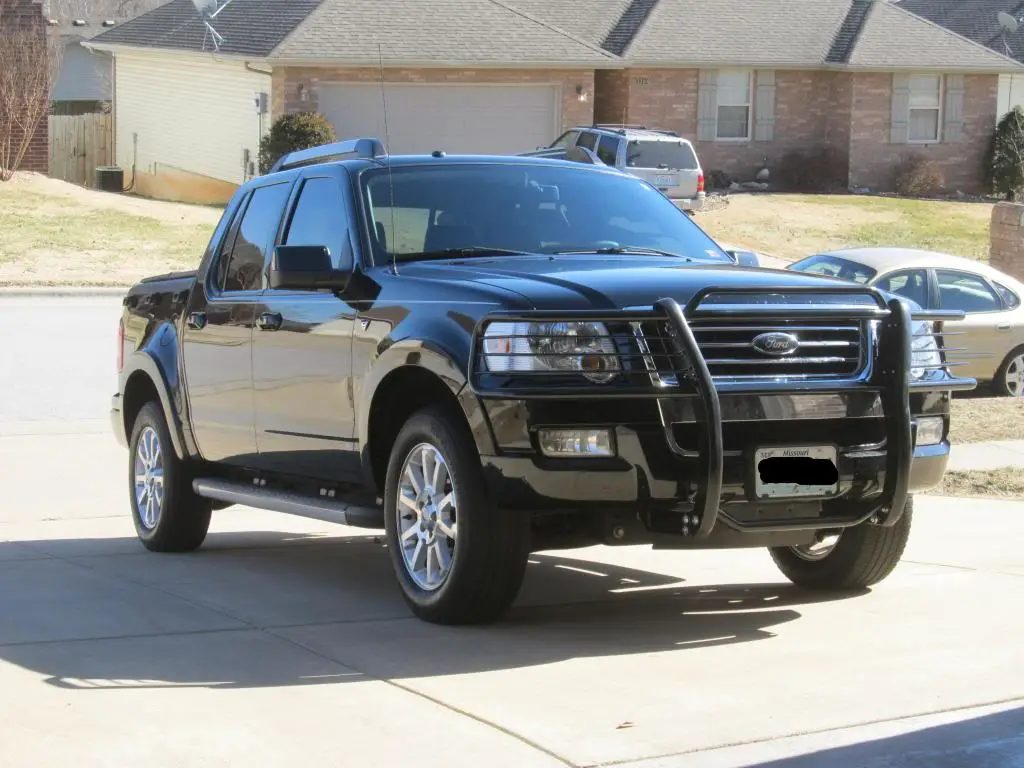

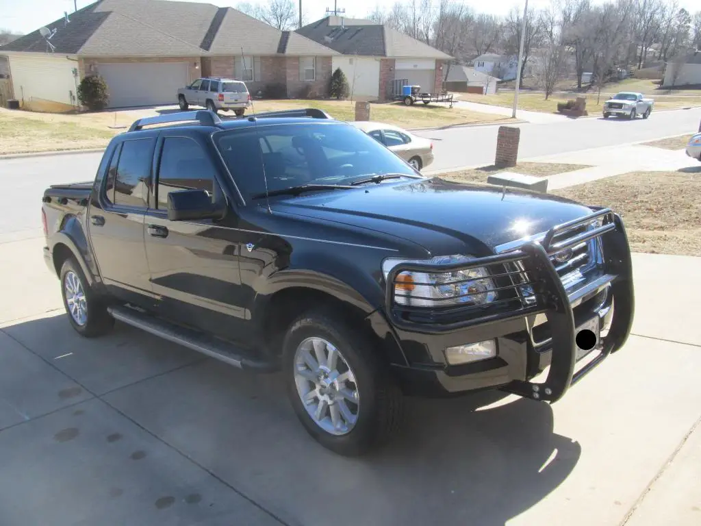

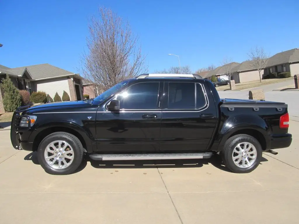

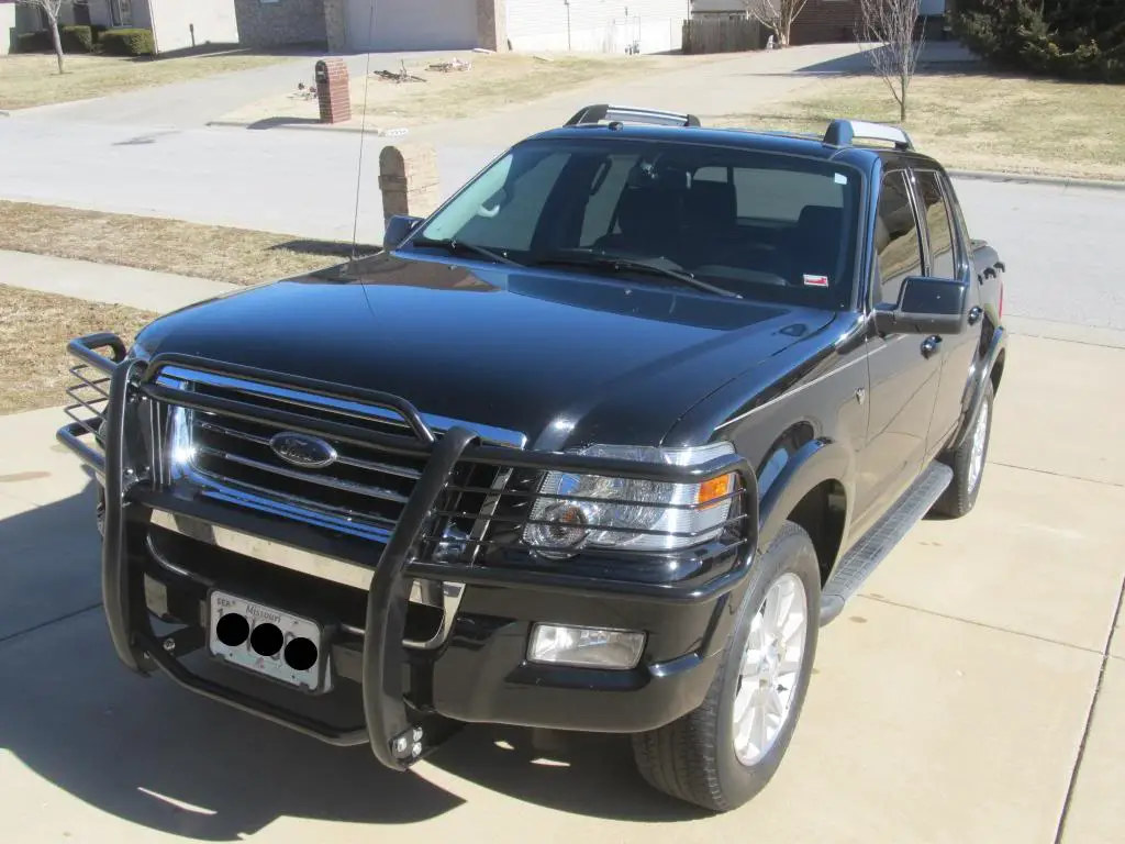

Here are a few photos of the installed product.
