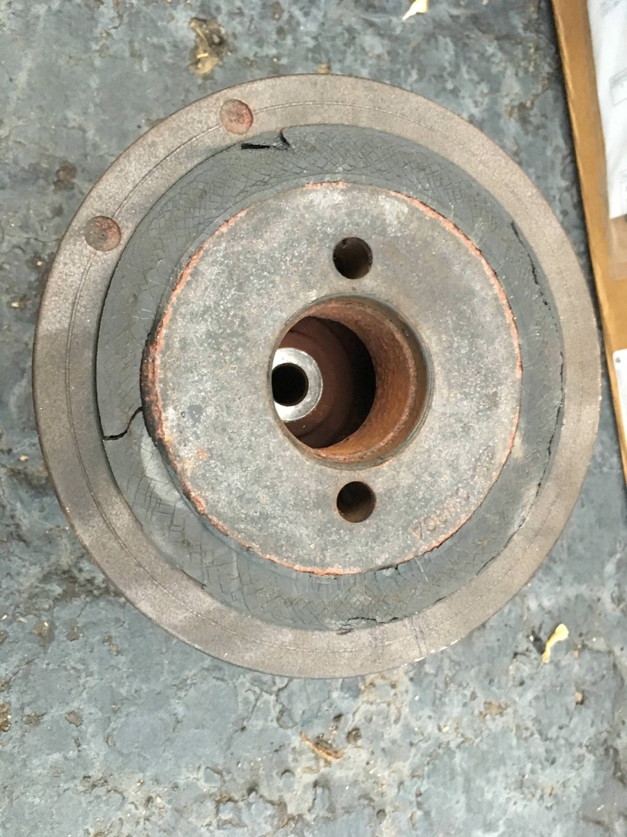

Old balancer with visible cracks, it was on its way out.
It was seperating on both sides:

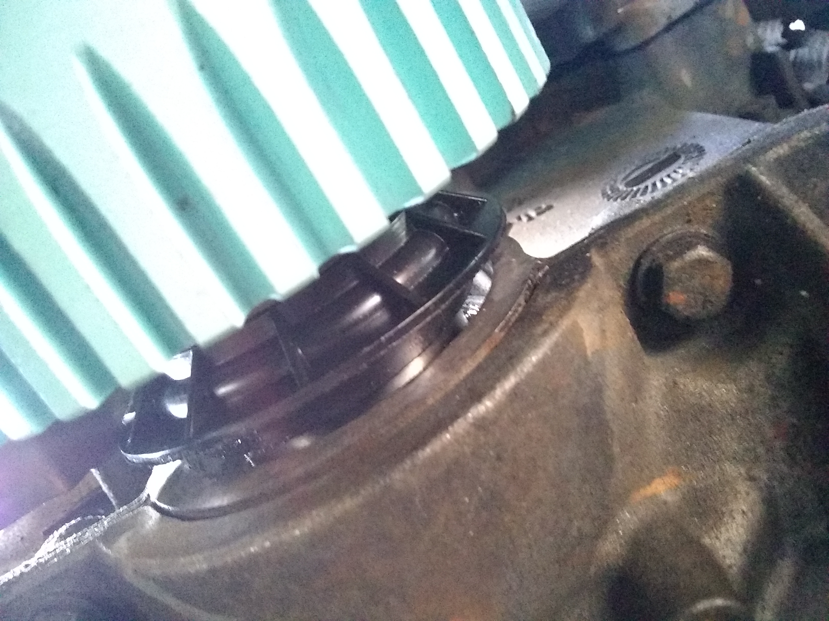

Removal:
Once you remove the shroud and the fan, there is plenty of room to work around.
