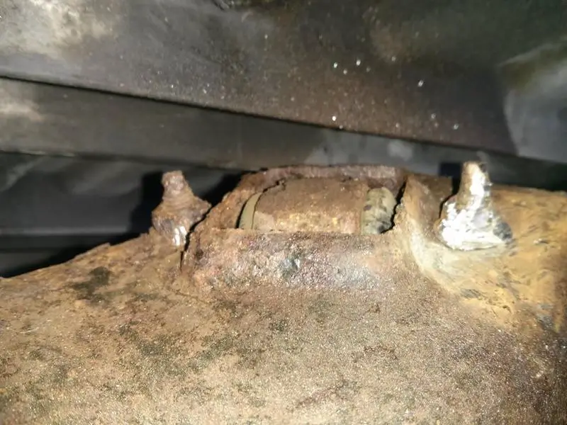

This weekend I changed out all shocks, other than the driver's side rear, replaced the sway bar end links, and greased the sway bars. All of that was pie, particularly because I used a sawzall on the top bolts of the front shocks. I forgot how nicely the Sport Trac rides with new shocks and sway bars and end links without slop.
The rear driver's side rear bolts, even with the spare removed, is seemingly impossible. The charcoal box has five bolts -- two on a metal strap on the left, one in the center, and two on the right (i.e., the setup is the width of the frame, not just on the left side), and hoses that cross the frame. I removed the left and center bolts for more room, but even then couldn't quite get to the top bolts. I didn't want to remove the entire box because I had a tough time disconnecting and reconnecting the hose on the left side.
I'm getting new tires this week -- Michelin LTX MS2 265-70-16, same as I had, which lasted almost 75,000 miles -- and have embraced my fail and will ask the shop to install one damn shock.
